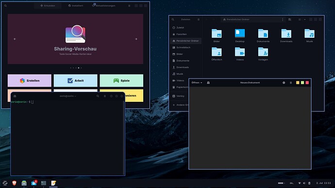

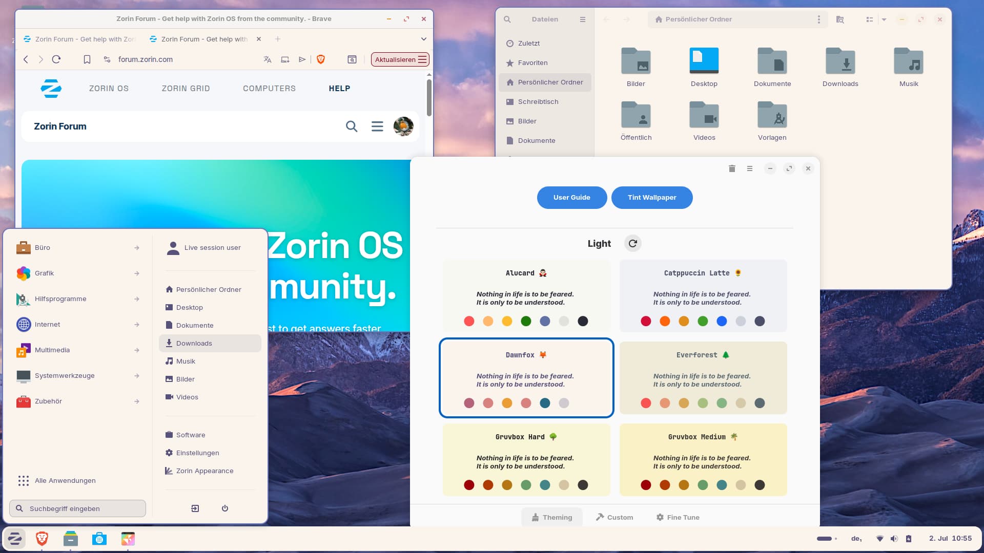

Oops, I completely overlooked that. I tested it now in a live session, and found it interesting. But I don´t like all things. Maybe there are some conflicts with the Zorin settings. The transparency didn´t work well. You can set sharp corners there, that is interesting for those users who don't like rounded corners. It worked well for many preinstalled apps, but not all. I also enabled "Window Borders" to draw an accented border around all windows. I didn't find out yet how to change the blue color of that border.

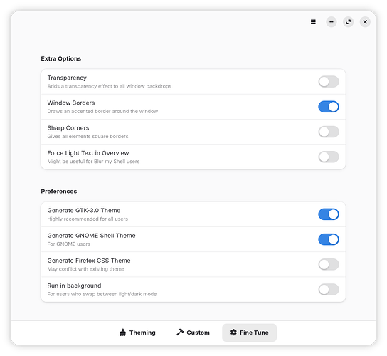

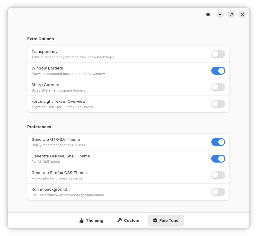

I disabled the function to run the app in backgound at tab finetune because I had problems to launch the app after logout.

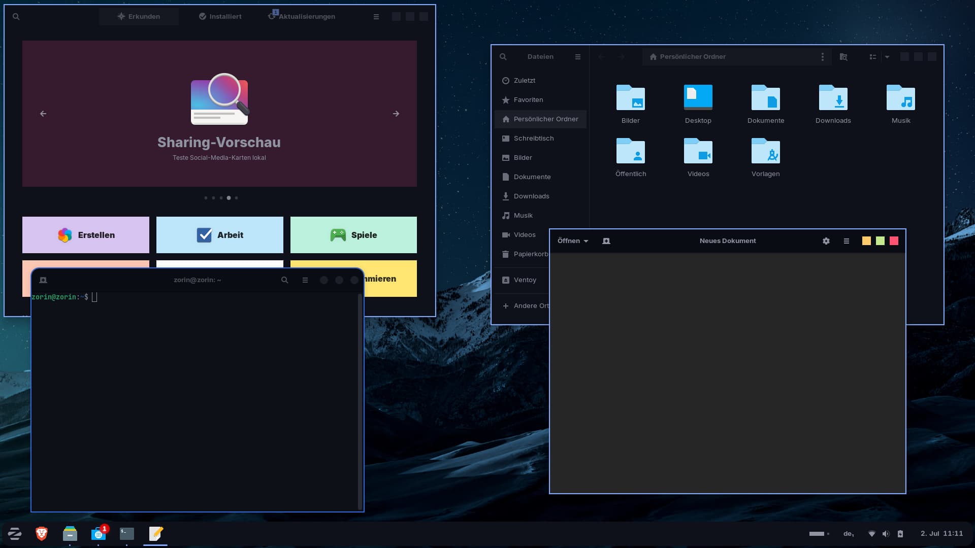

The buttons of the backdrop windows in the mac style didn´t look well (square light button, not round). And in the colored style they didn´t look consistent.
With sharp corners the buttons in mac style are squared buttons.
So finally, I think the app is not worth a recommendation. There are too many inconsistences.
Edit: On the github site were shown some commands to set the right permissions for the flatpak
sudo flatpak override --filesystem=xdg-config/gtk-3.0:rw
sudo flatpak override --filesystem=xdg-config/gtk-4.0:rw
And now the look of the buttons is better and the strange transparency errors are better but still problematic. I wouldn't use the transparency.

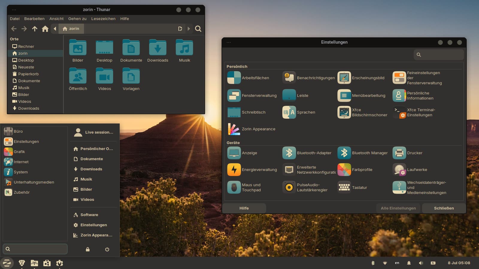

I tested Rewaita on Zorin 17.3 Lite:
Here with gruvbox soft theme dark and gruvbox plus dark icon theme and gruvbox B MB dark xfwm theme.
The blue window border didn't work correctly, just in gtk4 apps, but the theme worked. Not as good as in gnome because of the window title bar which doesn't has the same color, but okay.
The mac os window buttons are colored on active windows (here you don't see it because the windows are inactive because of Zorin menu)
I searched for an adwaita xfwm4 theme and found one one kde look, and it is a bit lighter than the black titlebar before, but the window buttons then have not the right color. I found no good xfwm4 theme for adwaita that fits to the adwaita gtk theme in Zorin 17 Lite.

This is because the Buttons go in the same Gruvbox Color Sheme.
