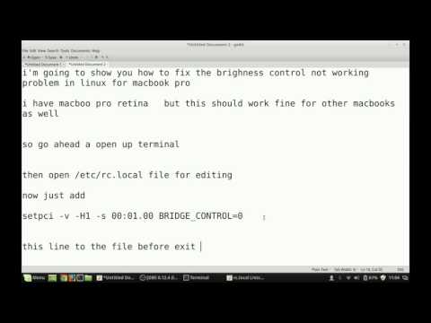

But how do I get brightness controls back? I haven't had brightness controls in 15 Lite or 16 Core with my MacBook Pro.
(Note: I do have brightness controls with the same install on MacBook Air or my old Gateway Windows machine)
Oops, I misunderstood that you did have a brightness control in Zorin 15.
[edit]
Video from 2016.
This might help:
