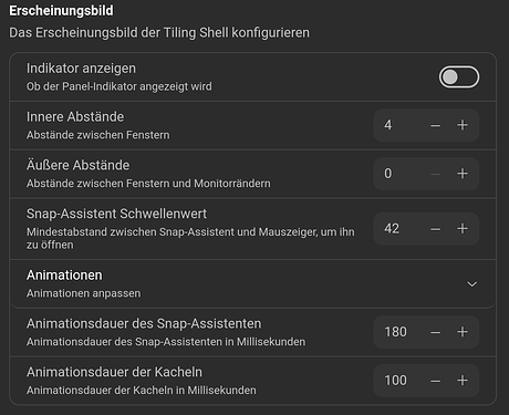

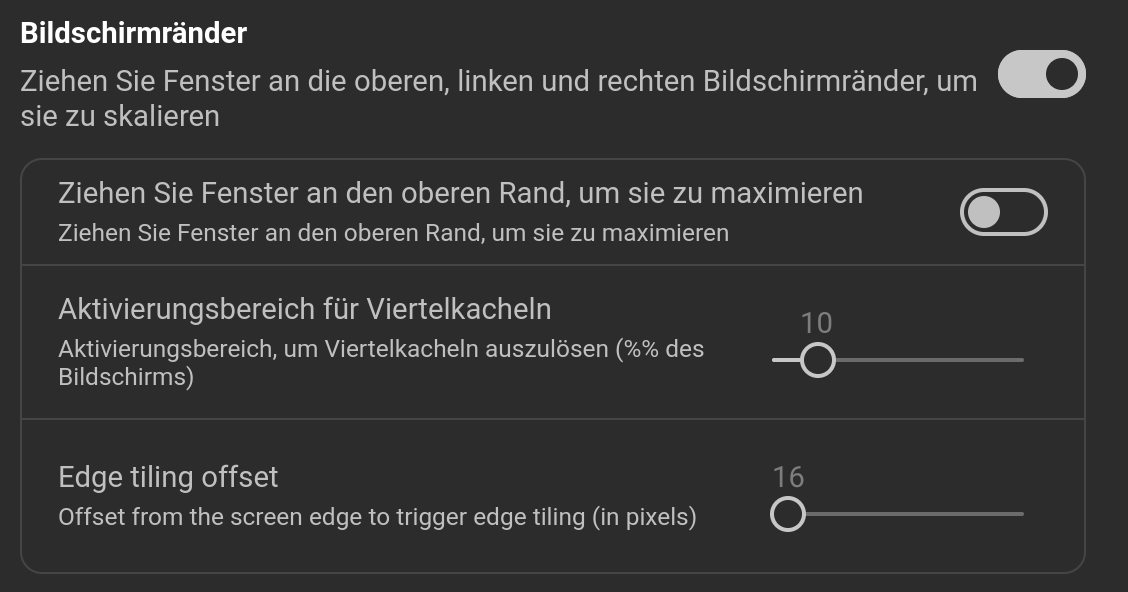

When You activate it in Zorin Appearance, You have a Gear Icon beside the Toggle. Click on it to open the Settings. There You have ''Appearance'':
and You have Screen Edges:
did You tried it with these Options?

Yes I've tried that, the problem is that I don't like the Zorin Appearance one because it doesn't have that instant response, I would need to hold the window there for a short while, but it has options to make the activation area bigger which in turn I am missing with the Active Screen Edges in Settings.
Is there any way to configure the Active Screen Edges within the Settings menu or make the Zorin Appearance Screen Edges instantly responsive?

You se on my first Picture ''Animationen''. There You can set up Timings when You make that shorter it might respond faster.
It's not about the animation, but how fast a resize gets triggered, but I just realized I'm stupid and I can double click applications to fullscreen them. I always dragged them so I forgot it even exists. I still need to adapt to it a little but the way it is now it works for my top screen where I use it the most and I don't want to install another tile manager for this little issue.
