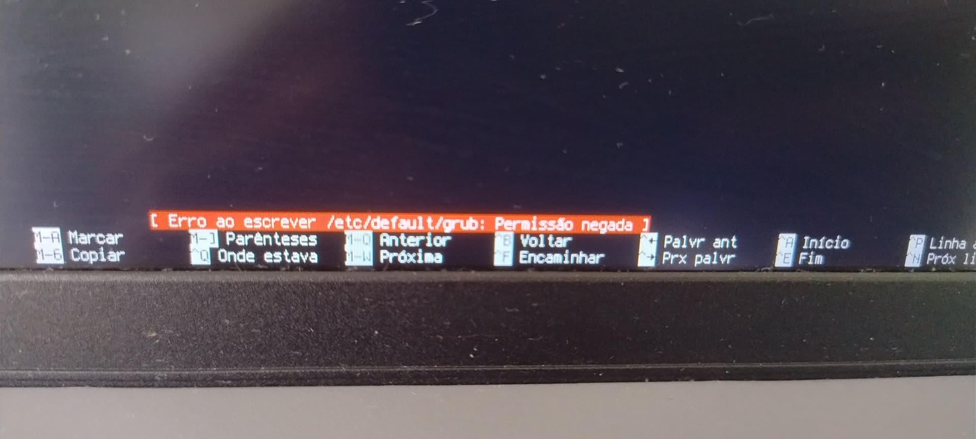

While I'm saving the changes it says error /etc/default/grub: permission denied
you forgot sudo
sudo nano /etc/default/grub
