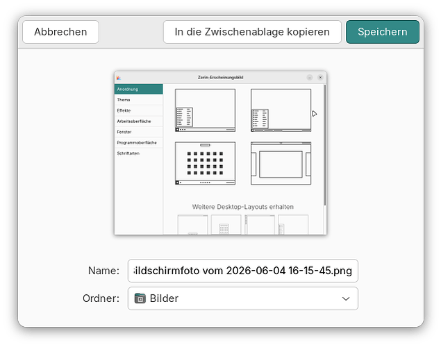

You can install gnome-screenshot. I use it myself because it offers a time delay and you are asked where to save the file and how to name it. It also works on Wayland.
You can install it with
sudo apt install gnome-screenshot

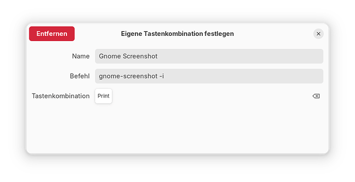

If you like, you can create a custom shortcut to open gnome-screenshot when you press the print key.
Command for taking a screenshot interactive by pressing print key:
