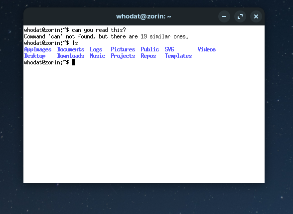

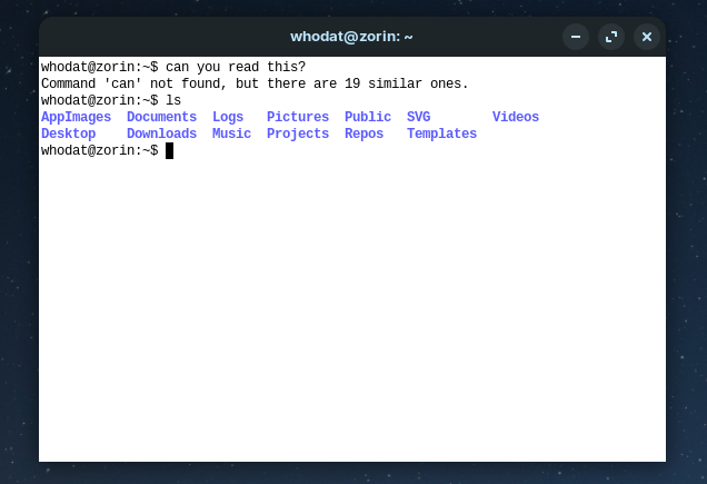

Shrinking Terminal?

I took a moment to look at the source code for Gnome Terminal and it looks like the Gnome Terminal windowed application has a mismatch in how it handles scaling.
This can create a situation where X windowing can miscalculate the DPI when scaling or GTK4s scaling mismatches the Xorg scale factor.
Either way, both of these are due to a bug within Gnome which leaves it solely on Gnome to repair.
What an end user can do as a workaround is use a different terminal emulator (as others suggested above).
Or they can set their Xorg conf file /etc/X11/xorg.conf to default to only DPI of 96

A person may try using dconf-editor or terminal to reset the Gnome Terminal saved window configurations
dconf reset -f /org/gnome/terminal/
Or gsettings to force the scale factor
gsettings set org.gnome.desktop.interface scaling-factor 1

Thank you everyone who joined in to give their thoughts and support, and special thanks to @Ponce-De-Leon for putting in so much time to help me with the issue.
Ok your investigation supports what Storm suspected earlier about a possible Gnome Terminal bug, so I will go with the easiest solution of using another terminal emulator as you and the others have mentioned.
