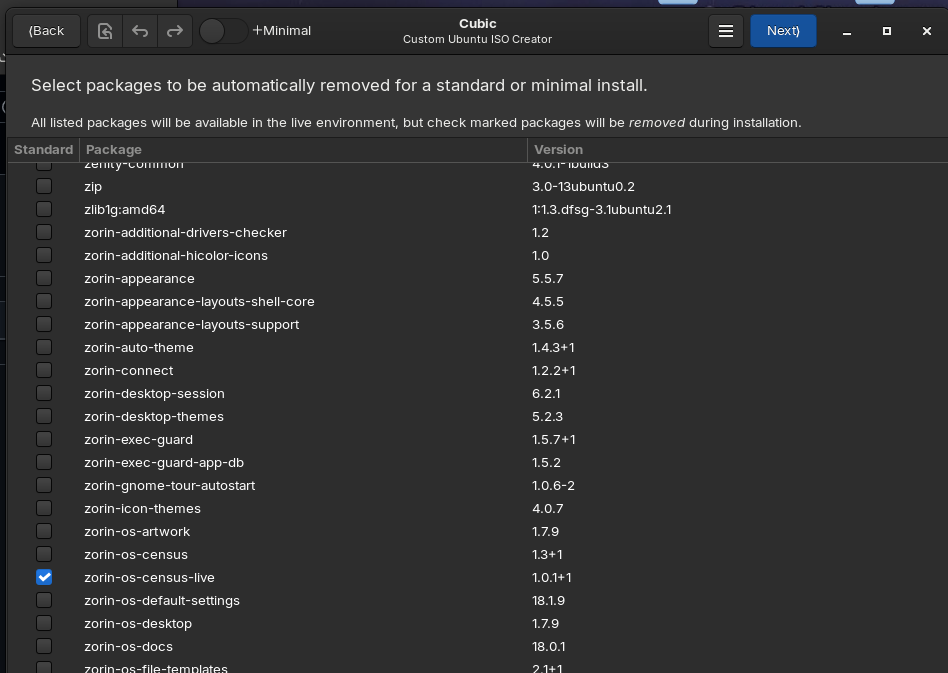

For an upcoming machine Acer Spin 311 AMD64 i need a slimmed setup but require the touchscreen functionality.
Question: Is it possible to edit the software list on a zorin core usb key? Means removing the big whoppers like thunderbird, evolution, libreoffice. So it's not required to install all of that first and remove it by hand later.
Where is the software list file on a usb key?

You can try Cubic
I will not say you it work because I didn't try
you tried ?
No, I haven't.
because it work on Ubuntu, so just removing some apps could be possible
Looks good, installed from PPA and it works. Will give it a try, Thanks!
Just tell us if you succeed...
Generally the tool accepts the Zorin ISO, this looks like the stuff i need.
It would be interesting to see whether the selected programs are actually not installed in the first place or are removed later. Some descriptions state that they are removed later. But of course, clicking here is easier than uninstalling each app individually from the app store.

Really good to know, i will try that out. The convertible has only a Intel Silverlake CPU that was made for schooling devices. So i thought claws mail and abiword / gnumeric will be the better matchings things for it.
The Cubic session can be reopened, so i can restore stuff that was checked for disable.
