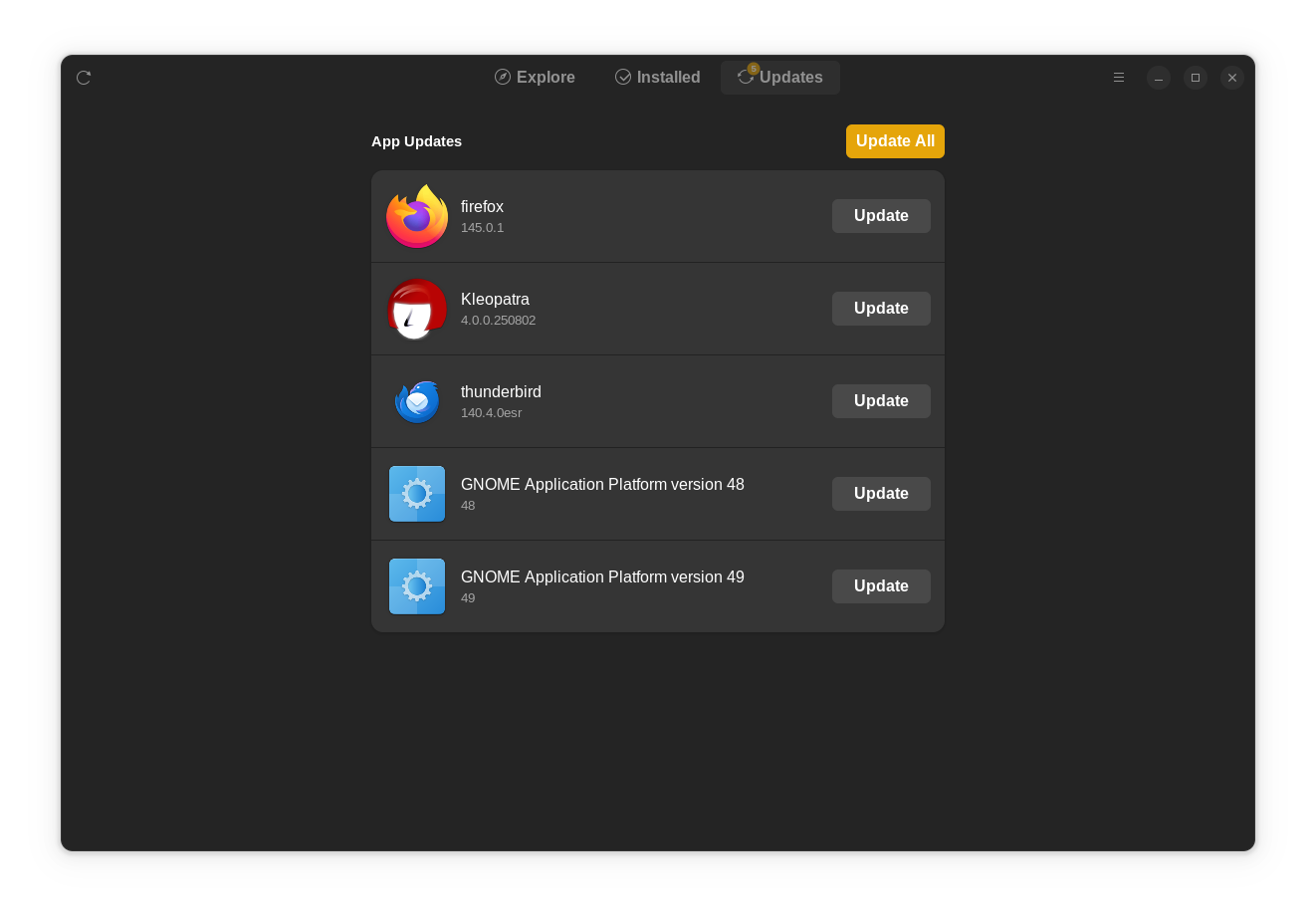

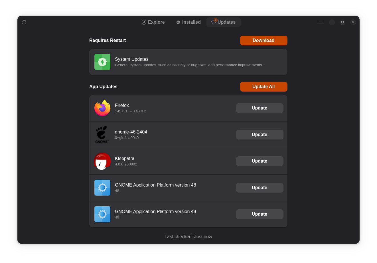

Not only for that. Here is a screenshot of the same app (Software) in Ubuntu 24.04 LTS showing available updates. There is even a little number on the updates tab that shows the number available.
I have to check the Zorin 18 version of Software, but in Ubuntu 24.04 LTS it's 46.0
dmn@Kayleigh:~$ apt show gnome-software
Package: gnome-software
Version: 46.0-1ubuntu2
Not only, yes. The last 2 Entries are Runtime Environment Updates for Flatpak Apps. So, this is related to Flatpak.
The Software app itself - so the gnome-software Package - for Example would be updated trough the Software Updater.
For system updates, Software would include an entry like this:
But, maybe Zorin's version does not have this?

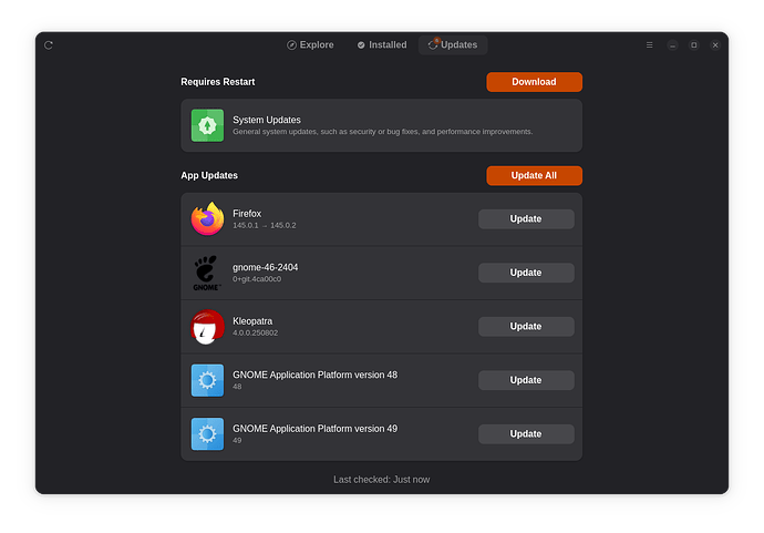

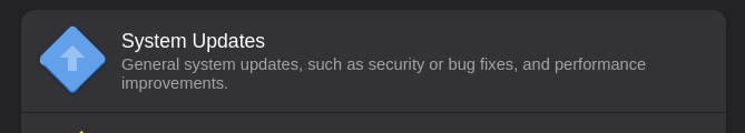

Here's some further evidence of differences. Went back into Ubuntu, this time 25.04, and a "System Updates" pane shown in earlier post is showing today:

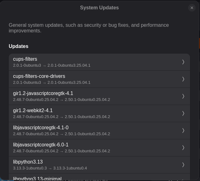

You can click on the "System Updates" pane to see details:
This tells us the Software App, in Ubuntu at least, is using apt to assist updating the above packages.
The other packages in the main window are either Snaps (Firefox) or Flatpaks.

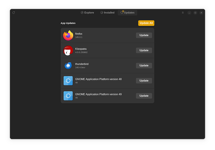

Finally, Software > Settings > Repositories shows only "Flatpak". Those handled by a plug in to Software.
