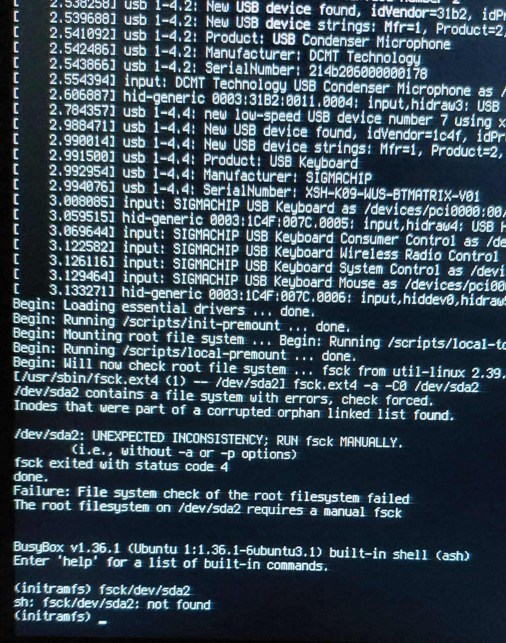

Okay here was the error I was getting. I was able to use my other computer to look up what this all was. I managed to get it all working again,
but it was a bit of a hassle. I don't know if there is a way for Software Updater to ping the internet connection before it starts or if there is a way for the system to pause until everything is connected better, but this has happened twice to me this year. My internet is usually good, but sometimes it flakes out. Anyway, all is good again.
What is shown in the screenshot is that sda2 had file system errors and it recommended running
fsck /dev/sda2
Which I assume you have now run with the space between fsck and /dev/sda2
A network connection error causing file corruption can lead to this - but is less likely than Disk Write Error being the actual cause.
Have you run a S.M.A.R.T. (test) on sda2?
