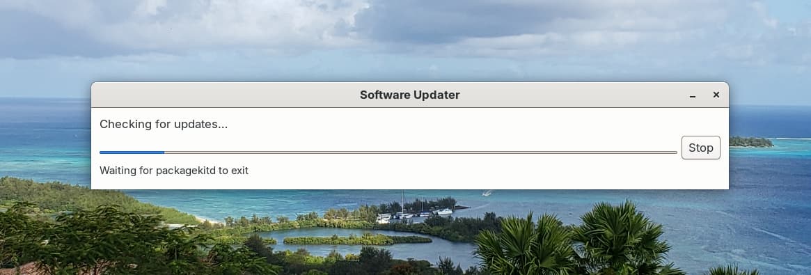

Started an update and left the room. We had a brief loss of electricity, don't know if the update was finished. When I check the Software Updater, it stops here.

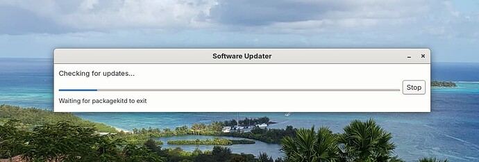

Hello,
do this in terminal
sudo apt purge ~c
sudo apt install --reinstall packagekit
That seems to have taken care of it. Thank you for the assistance.
