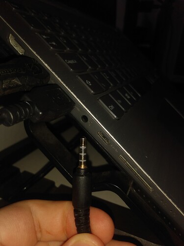

Hello, this is my third time trying zorin, interestingly, it is also my third day with the system, I have a problem with my headphones, for some reason, when I connect the cable to any of my headphones an icon starts flashing on my screen [image 1], when I disconnect it, it stops, I have identified that when I press the media buttons on my keyboard (Play/Pause, Previous Track, and Next Track) it shows the same icon, my headphones don't have specific software or drivers, and the controls for one of them only change the headphones themselves, and don't manage the audio system, I also noticed that when the settings application is open, or any other audio-related program is open, it stops giving this error, I've tried almost everything, but it still doesn't fix it, the audio comes out normal, but with this icon, another thing I noticed is that, if I play a video on YouTube it runs fine, but if I press the pause, about 10 seconds later the video plays by itself, I don't know what the problem could be, I'm looking forward to testing the system but this error is frustrating me a lot. :frowning_face:

As soon as I plug in the headset, the icon [:no_entry_sign:] starts flashing at the bottom corner of the screen without me clicking anything. The same icon appears when I press the Play/Pause, Previous Track, and Next Track buttons. My laptop is a Lenovo Ideapad 320, and my headset is an AOC GH 100. It has a button to mute the microphone and a volume wheel, but these only affect the headset itself, the system does not recognize these commands."

I use it in the headphone jack (I'm not exactly sure of the name, but I believe it's the one you mentioned, audio jack). My headset does have a USB output, but it's only for the LED and doesn't affect controls or functionality (I've tested connecting it together, but nothing changed).

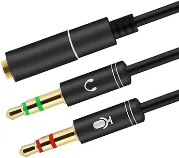

I think I know what your problem is. It will be like these headphones:
Which means you need this:
The flashing will be down to the fact that it senses your single headphone jack also carries the microphone signal. I gave my eldest the keyboard mouse and headset I had bought for myself and that was for a pc tower and needed an extension cable as well as front ports weren't working correctly so had to go to rear outputs. Was looking on Amazon to see if I could find one with 3 rings on the jack plug as I think you would need one like that. 3 rings means it is TRRS. And fortunately the fiance had such a splitter.
I was ready to come here and tell you you were wrong, but I wasted 3 days trying to get this to work so... what's one more test? and to my surprise... Everything went back to normal (I was like: WHAT???) my headset came with this adapter, but I would never have thought that adding it would solve the problem.
I don't know if there is a way to fix this by software or command so I don't need to use the cable, but anyway this will work.
Thank you swarfendor437, this solved my problem, and thank you Aravisian and Ponce-De-Leon for trying to solve it. :grinning:
