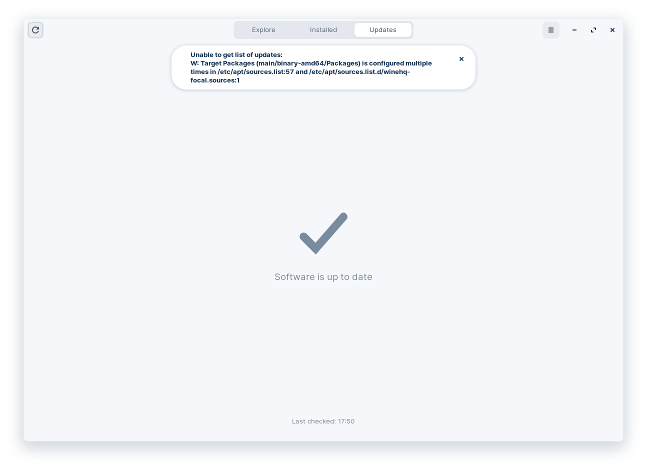

I occasionally also get this:

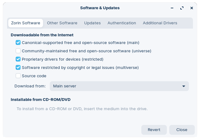

If Software Updater is set pointing to a regional server, set it to "Main Server".
It already seems to be set to main server.
Screenshot from 2023-08-17 17-58-36

Just as this message says, you have duplicate sources.
In terminal, you can run
sudo apt update
and double check for other errors.
If you elevate to root
sudo -i
Launch file manager
nautilus
Navigate to "Other locations" in the left pane. Then "computer" in the right pane. Now, click etc to open it. Then apt. Right click on sources.list and select to open with Text Editor.
In the text editor, display Line Numbers.
Scroll down to line #57 and check if it is for Wine.

Line #57 seems to be for Wine. deb https://dl.winehq.org/wine-builds/ubuntu/ focal main

You can remove
# deb-src https://dl.winehq.org/wine-builds/ubuntu/ focal main
and keep the source you have saved in /etc/apt/sources.list.d as the only Wine Source.
Be sure to save the sources.list after making changes.

That URI is the same as in the sources.list file. Do I understand correct that I shouldn't replace anything in sources.list, just remove those lines?

Correct. Those lines are a Duplicate. Possibly from making more than one attempt to install Wine by adding the repository. Just remove the duplicate lines exactly as I quoted them above.
Once they are removed and the file saved, running sudo apt update in terminal will refresh all your sources.
So you would need to re-launch Gnome Software Store after doing the above.
