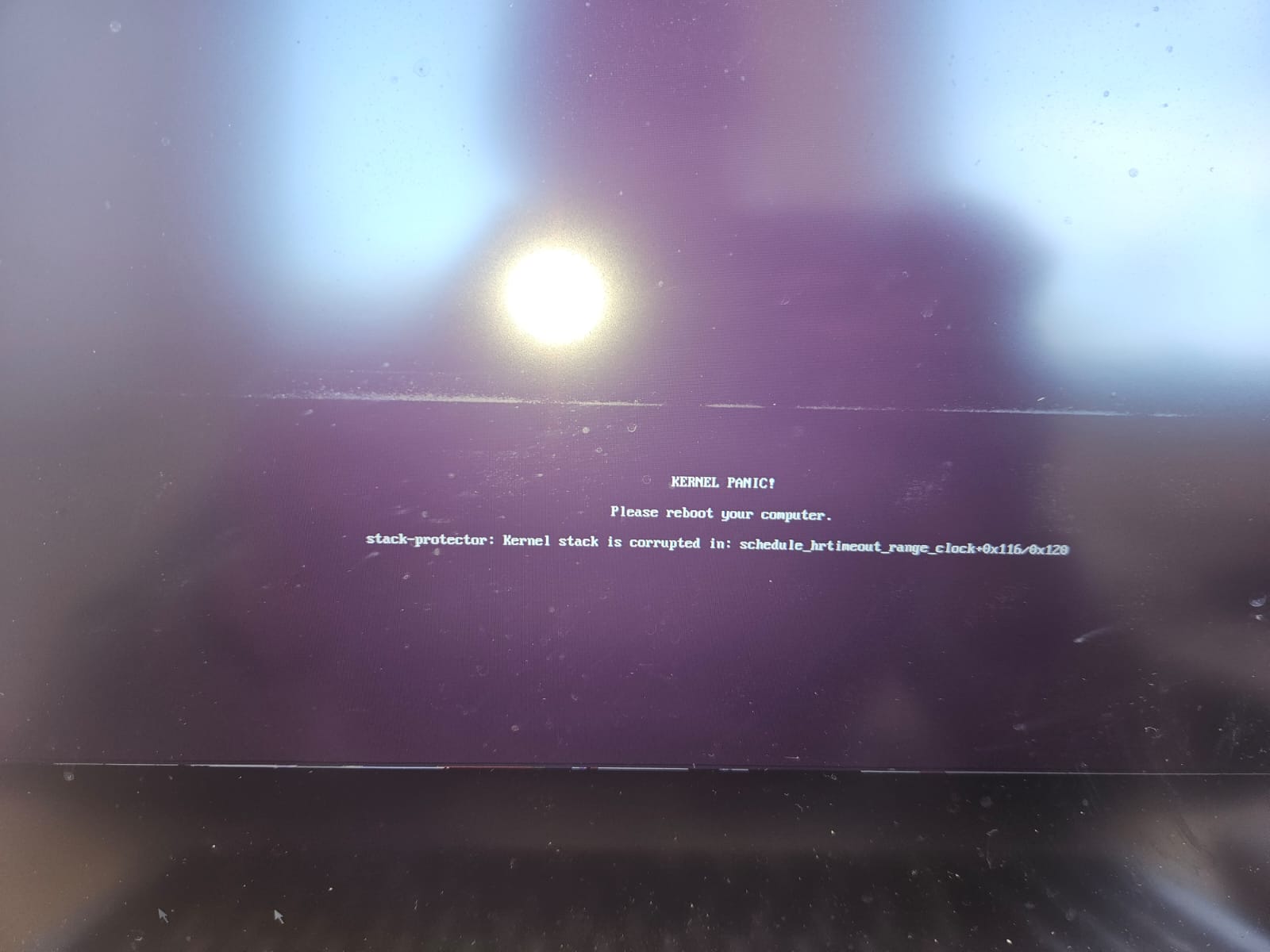

Now I'm running Zorin OS 18 (Ubuntu-based) on the same machine, still with just the Kingston in slot 1, and I got this:
KERNEL PANIC!
Please reboot your computer.
stack-protector: Kernel stack is corrupted in: schedule_hrtimeout_range_clock+0x116/0x128

Most likely this is due to memory failure....you can at start hit esc key or tab key to get into the grub screen then move down to the memtest 86 and see if it see something there.... maybe a memory module is failing or cpu might be or even a motherboard failure.. but start with basics run the mem test and see what it shows and post results here...Please
Ans also did you update to the 7.0 kernel and this happened maybe also try choosing a differnt kernel and see if that solves the problem
Try to boot in the older 6.17 Kernel and check if it still happens. To do that, choose on the GRUB Menu ''Advanced Options'' and there choose the one with the 6.17 Kernel and without ''Recovery Mode''.
Also: Are Secure Boot and Fast Boot in BIOS disabled? Is Fast Start-Up in Windows disabled?
I would just install 1 memory module in your computer since some motherboards do not like mixed memory brands or types. In addition you can test the memory modules one at a time in your computer until you find the bad memory module causing your issues.
