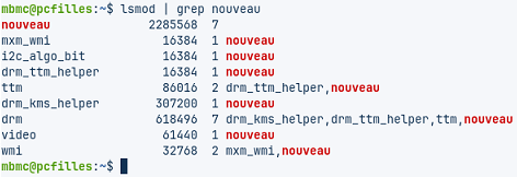

Lets see if the driver is in use:
lsmod | grep nouveau
The driver is fine it seems. Then the problem lies with Steam itself.

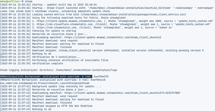

Now that I'm a terminal expert ;), I launched both Steam to learn more:
steam
(It launched!)
I close Steam...
flatpak run com.valvesoftware.Steam
(It crash)
(thanks Storm for the command :wink: )
So, Steam deb works again, but for how long...
