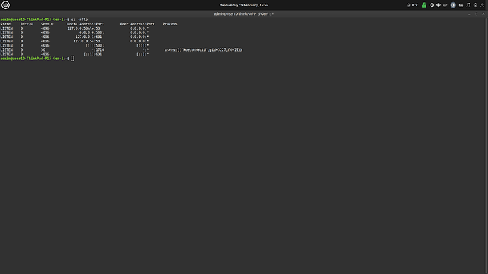

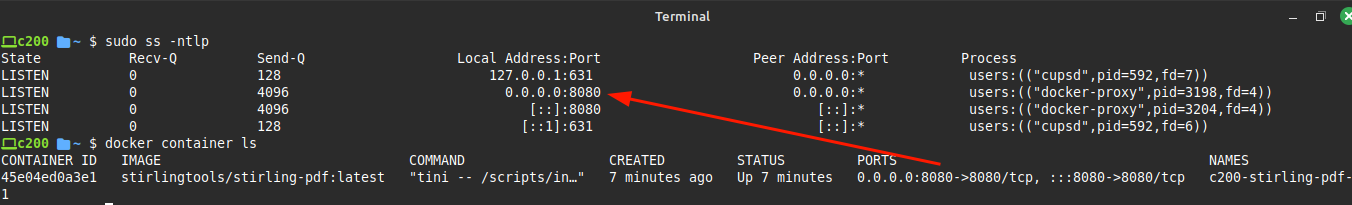

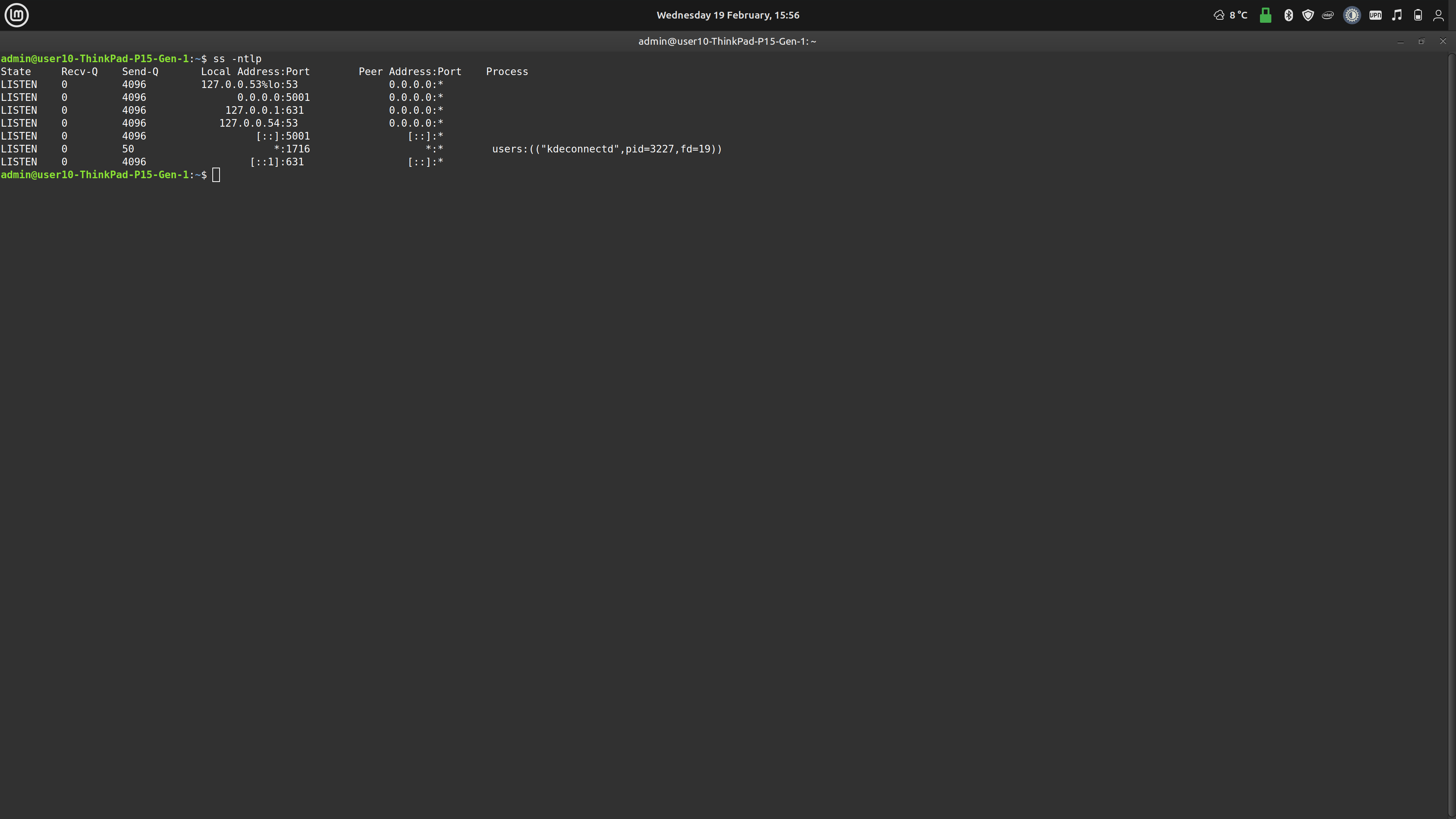

Let's see also the output of:
ss -ntlp

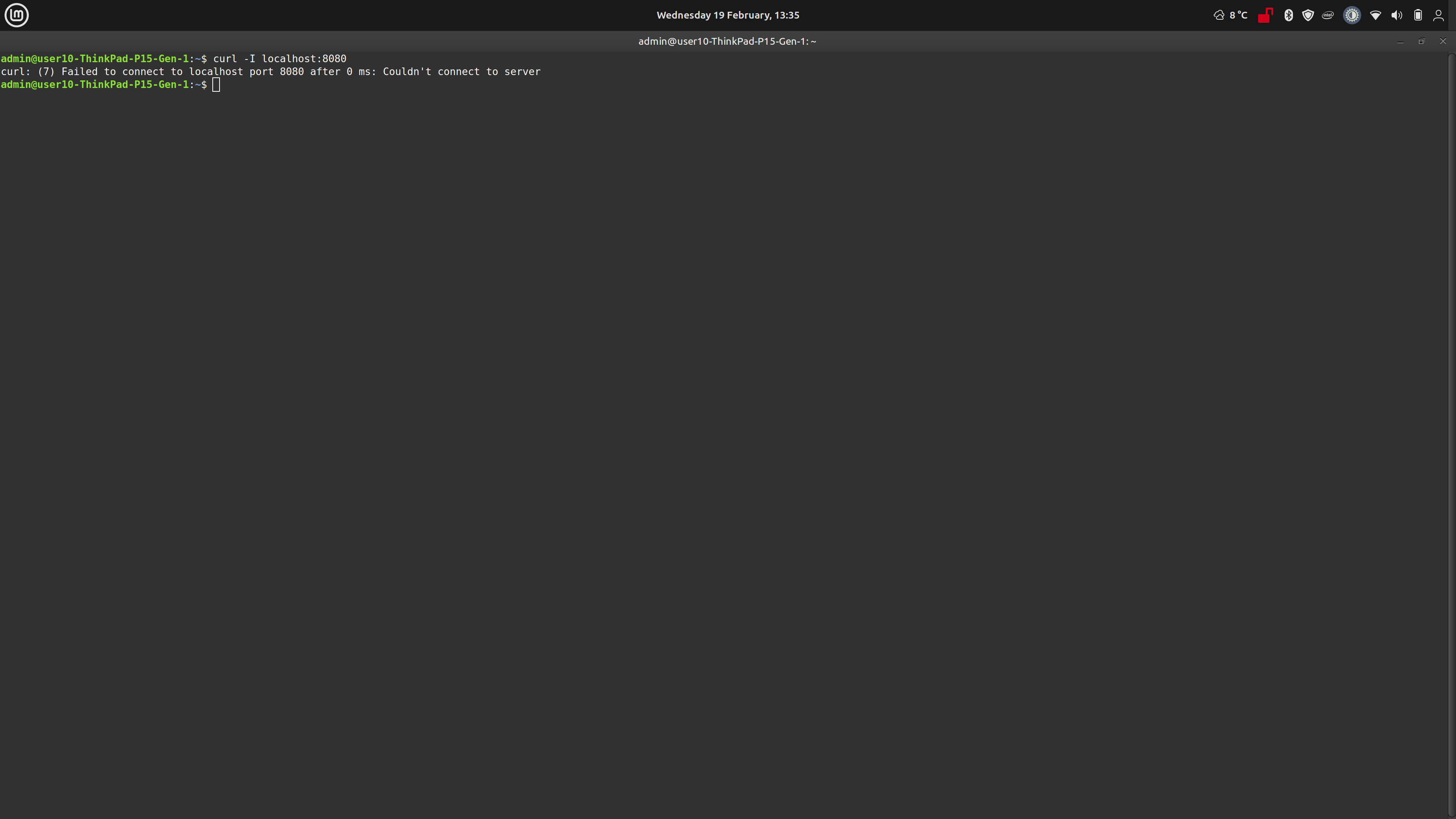

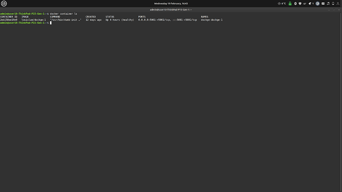

Is this with the container running? Check with docker container ls. Both commands should show that port 8080 is in use:
is this what you wanted?

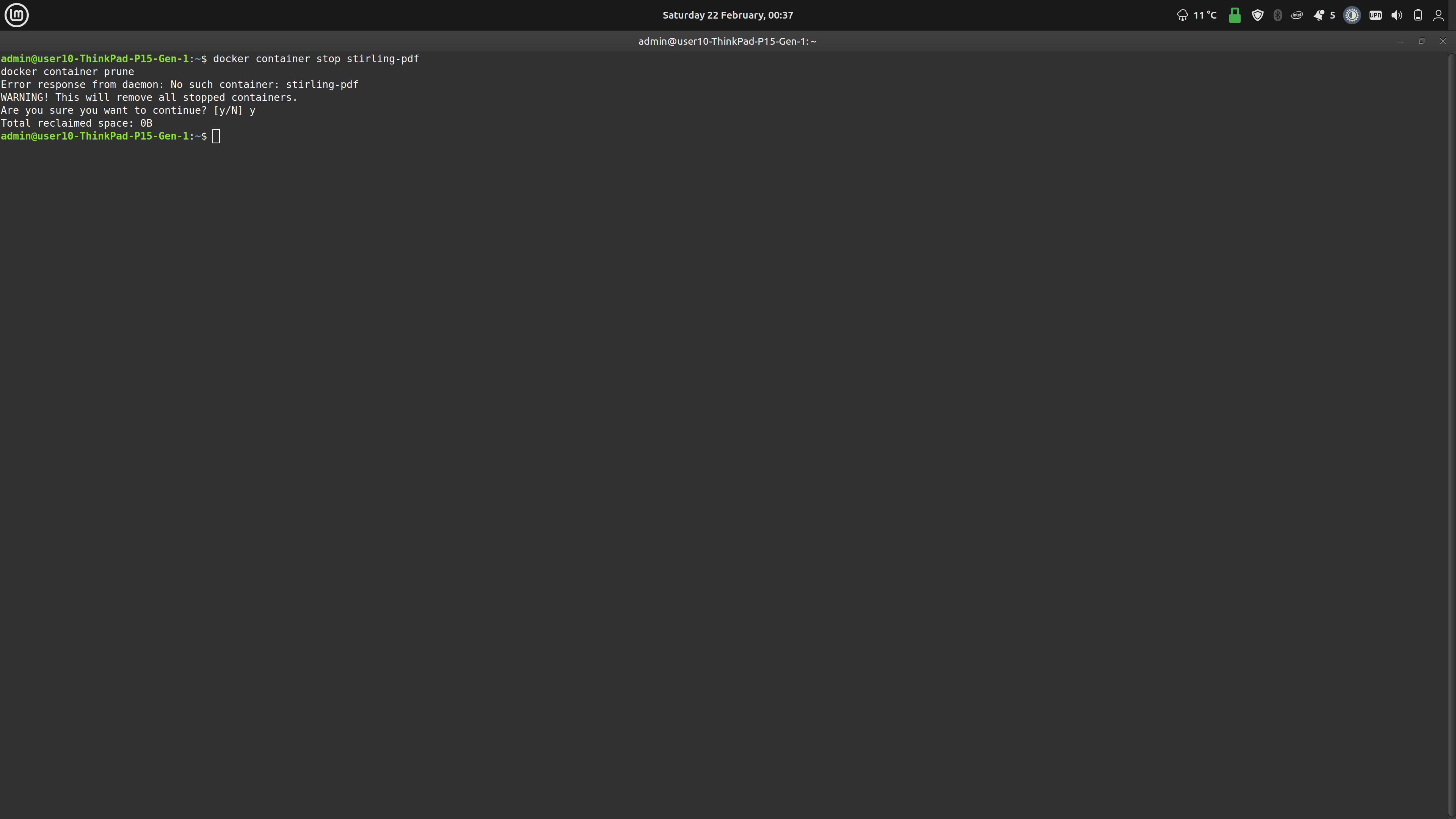

Well, since it's already in place, let's try to use it. First, stop any remaining containers for good measure as we've been doing thus far:
docker container stop stirling-pdf
docker container prune

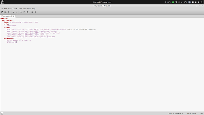

Create a new file named "compose.yml" with the following contents:

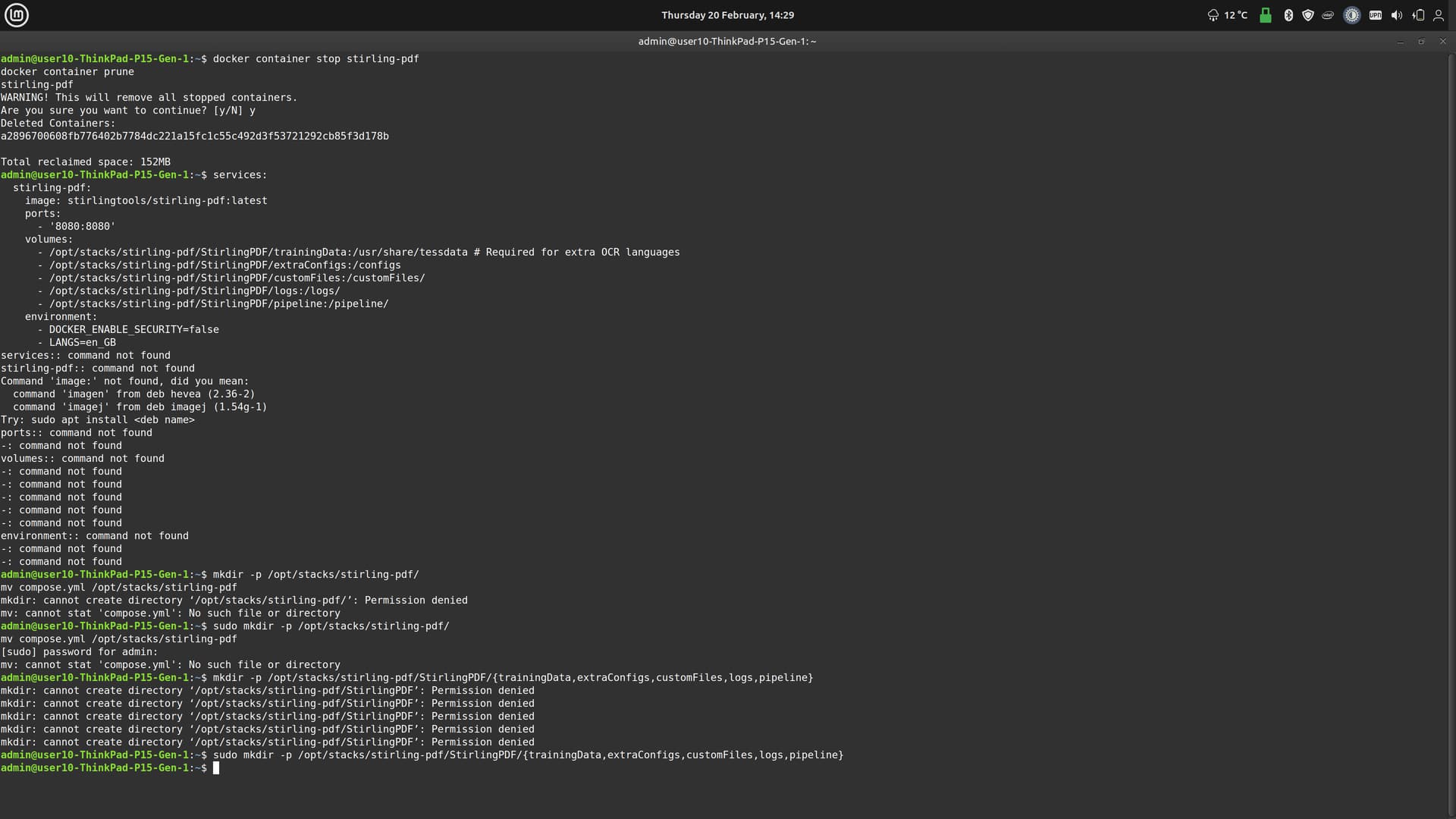

Following dockge's instructions, we need to create a new folder at a specific location, and move this newly created file over there:
NOTE: If any of the following commands result in a permission error, repeat them but adding the word sudo in front of them.
mkdir -p /opt/stacks/stirling-pdf/
mv compose.yml /opt/stacks/stirling-pdf
You'll have to create a new folder structure for Stirling PDF, as usual, but at this new location:
mkdir -p /opt/stacks/stirling-pdf/StirlingPDF/{trainingData,extraConfigs,customFiles,logs,pipeline}

I'm afraid nothing worked :joy:
What is going on with my system! It really doesn't like Stirling PDF.
Tried going straight to localhost:5001
Nothing.
and this is the history of my terminal:
Oh, no! This one isn't a command you run, but a file that you need to create. Just a plain text file, using the text editor of the same name already installed.
Although I agree that something smells funny, so to speak :joy: It should've worked earlier... so it's either this "dockge" that is installed (do you remember setting it up yourself?) or how Docker itself is installed.
So, take a closer look at my previous post. Everything is a command except that big chunk of text that is supposed to be a file named "compose.yml".

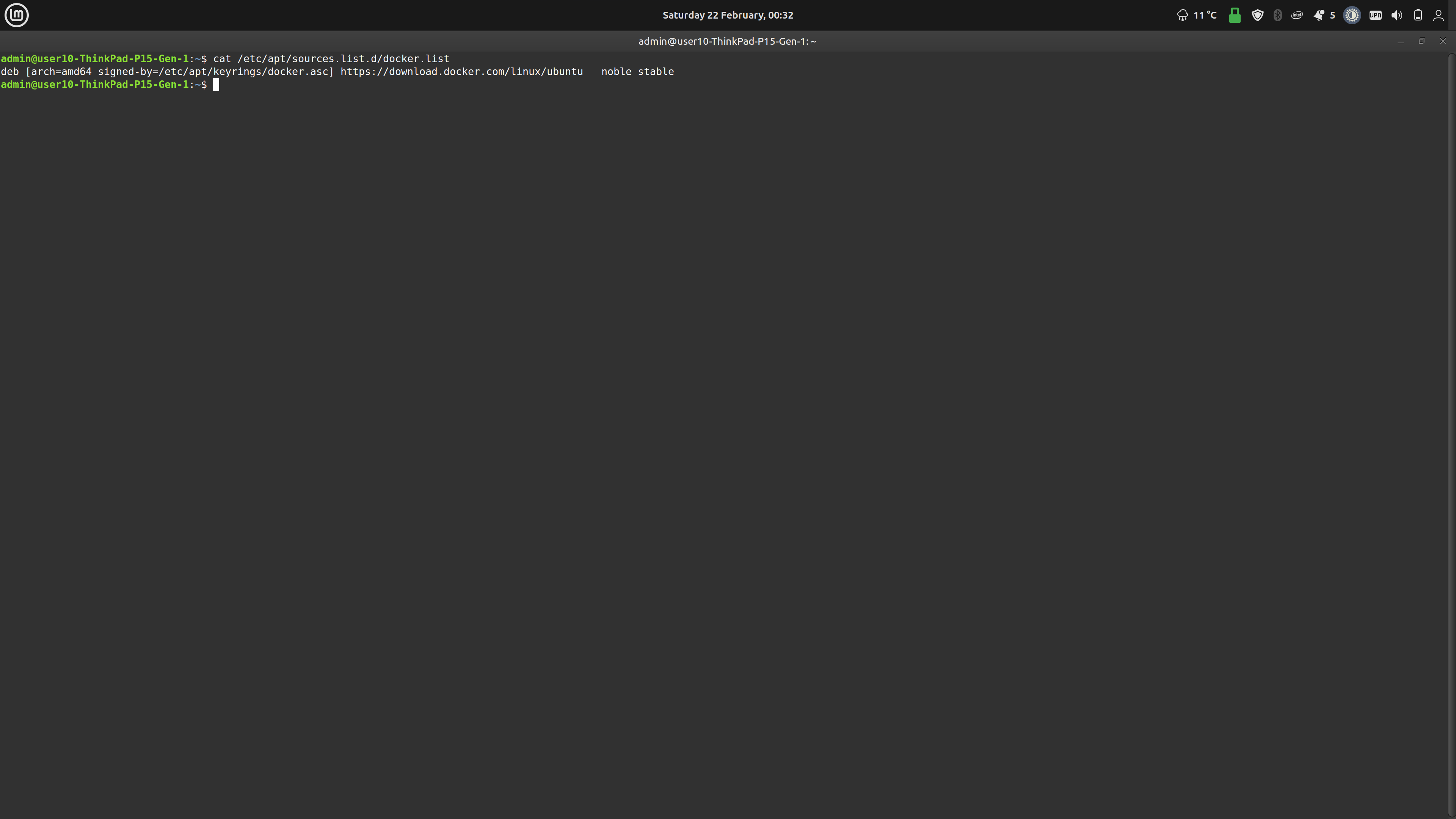

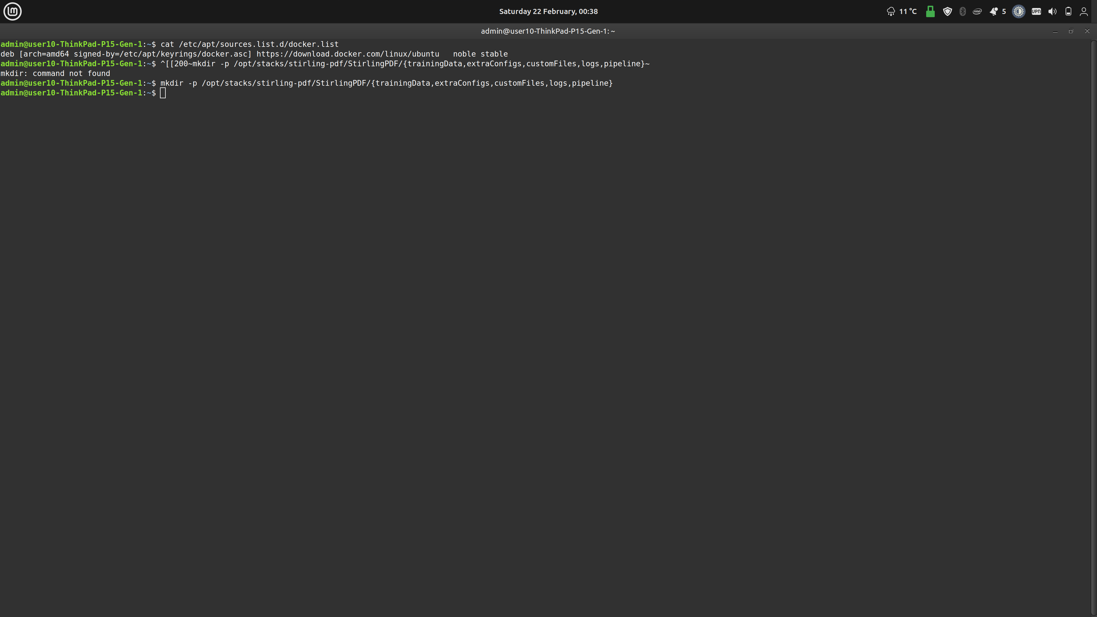

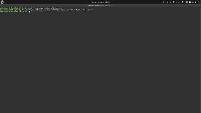

Also, just curious, what is the output of:
cat /etc/apt/sources.list.d/docker.list
It may return an error saying that it doesn't exists, that's also fine.
Ah man, sorry! I was rushing! Ok, let me try that again creating that file.
This is the return of the command you requested:

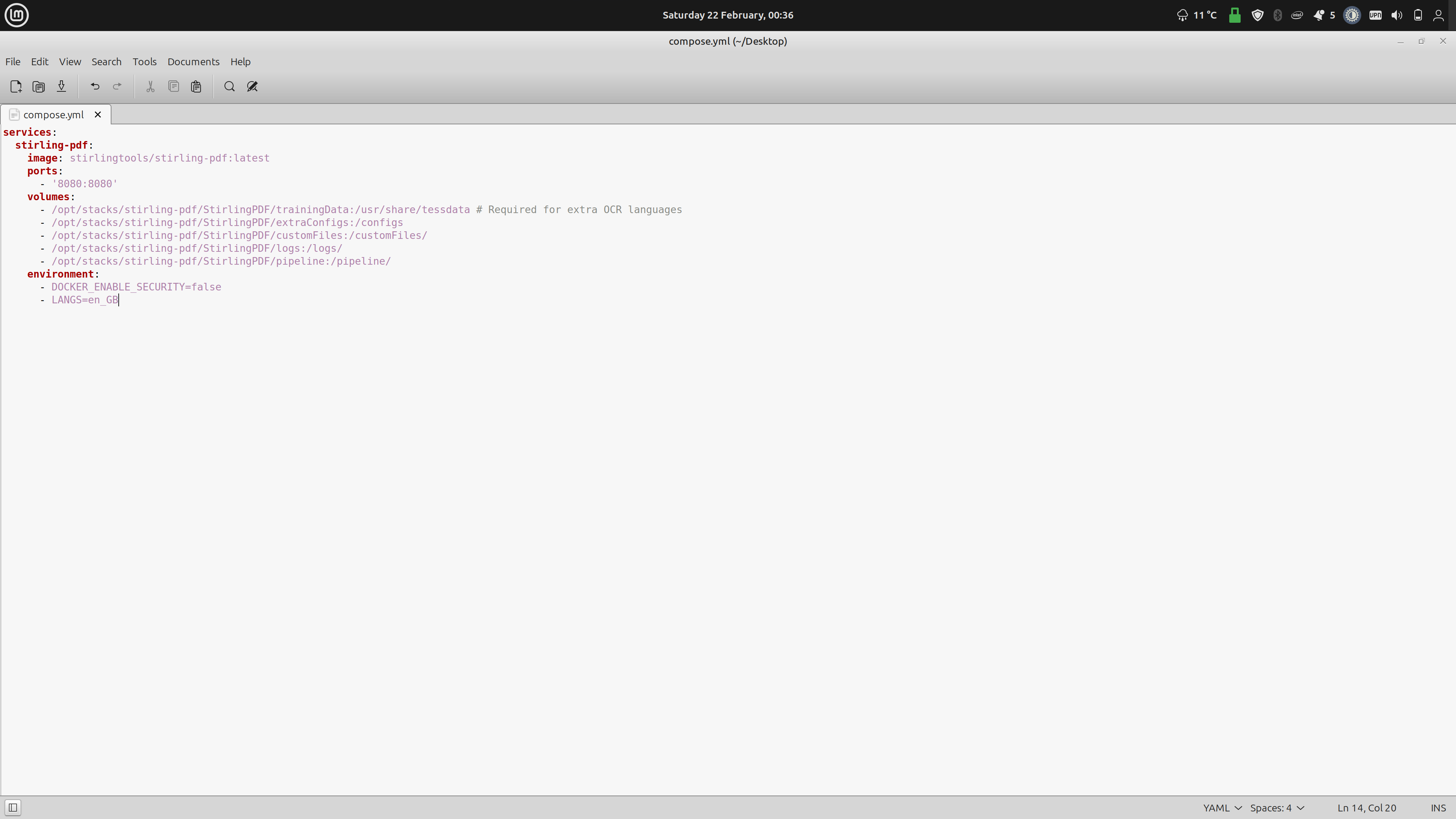

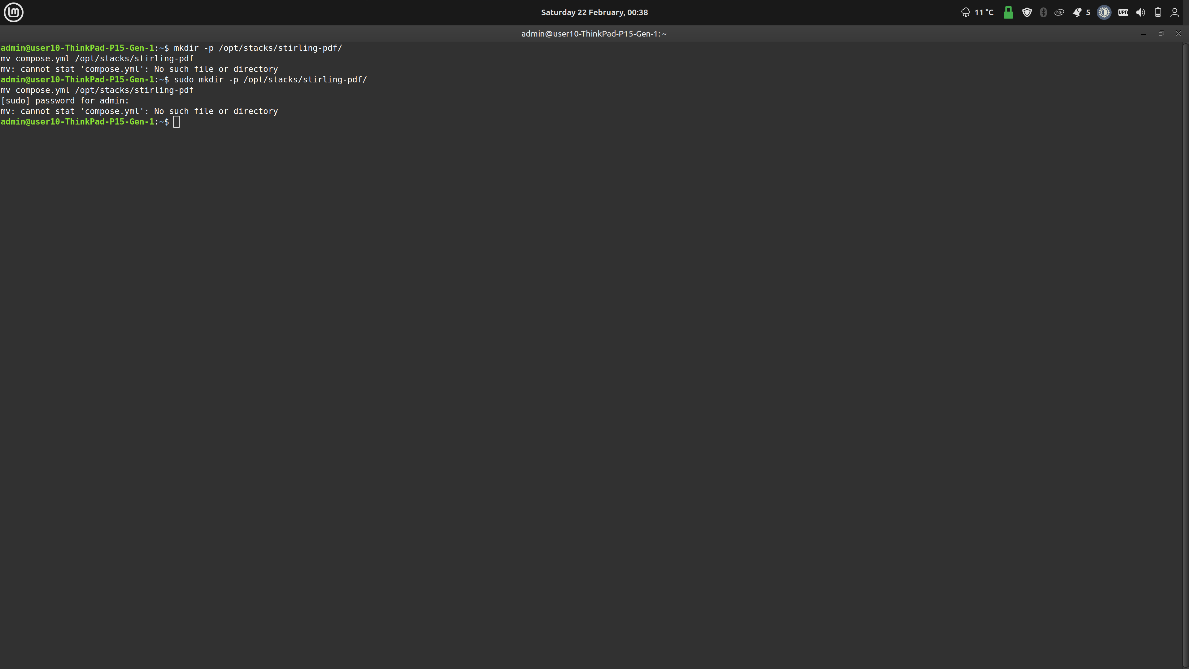

I'm sorry, maybe I screwed it up again but still no good... I created that text file with the code:
I didn't know where to save it so just saved it to the desktop.

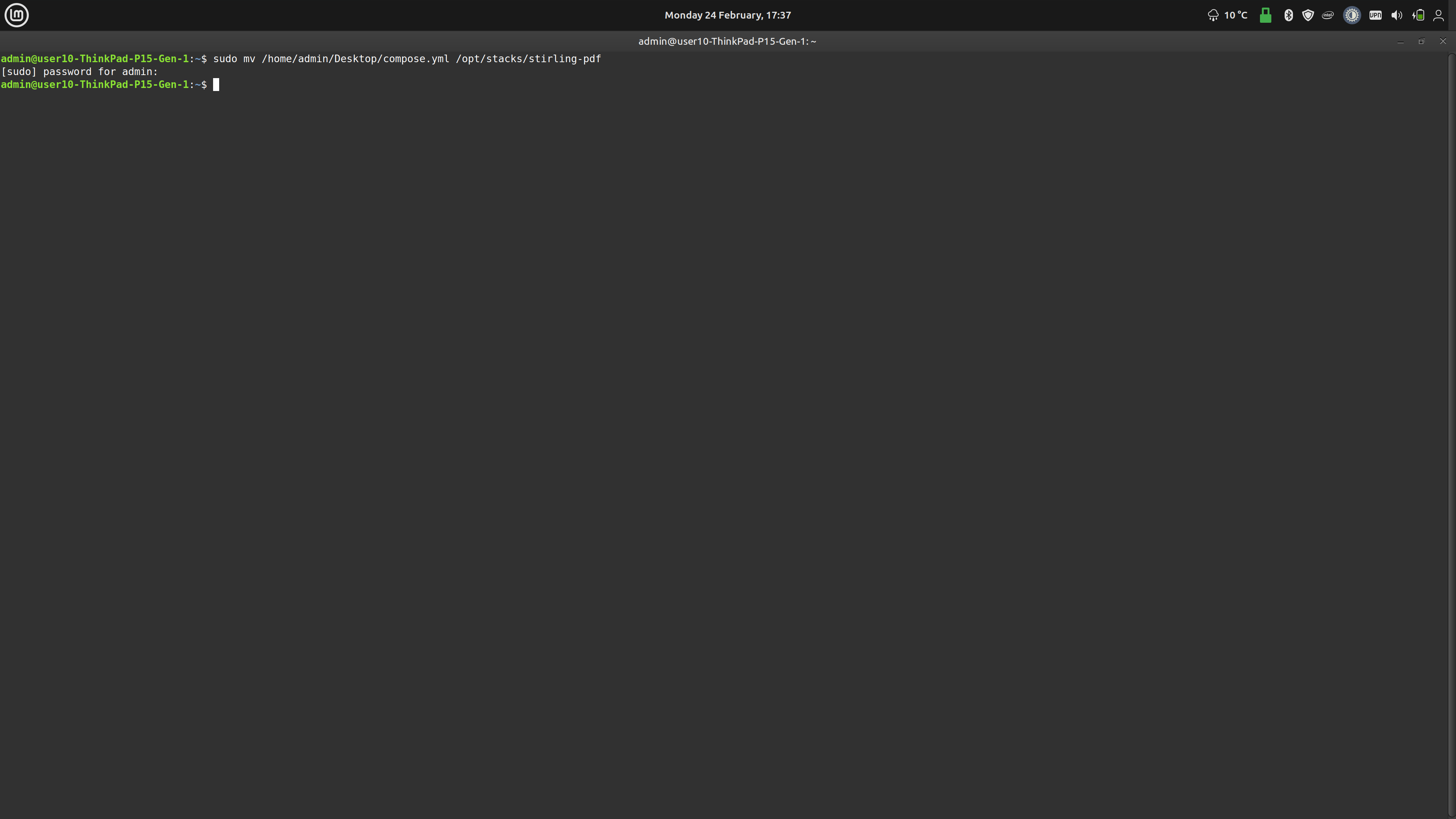

I then repeated the commands you mentioned but still no result:
That's fine, but then you'll have to adjust the command to move the file accordingly. This caused an error, as per your screenshot, saying that it couldn't move the "compose.yml" file because it didn't find it in your current directory. If it's in the desktop, this should do it:
sudo mv /home/admin/Desktop/compose.yml /opt/stacks/stirling-pdf

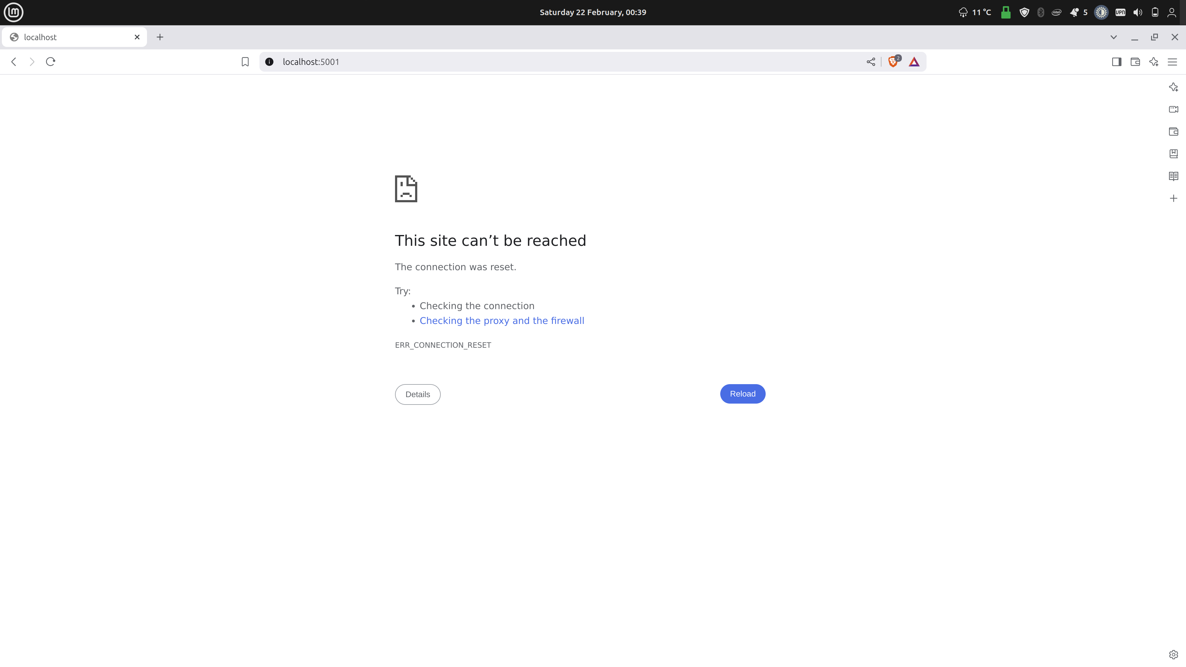

But, it still is strange that you cannot access localhost:5001. Did you try to disable the VPN?
Ok! something happened!!
It was to do with the VPN.
This is what my terminal came back with:
This is when I visited localhost:5001 with the VPN on:
This was it when I turned the VPN off:
So it was the VPN all along... which provider is it, if you don't mind sharing? I would very much like to know why they're blocking connections to localhost :joy:

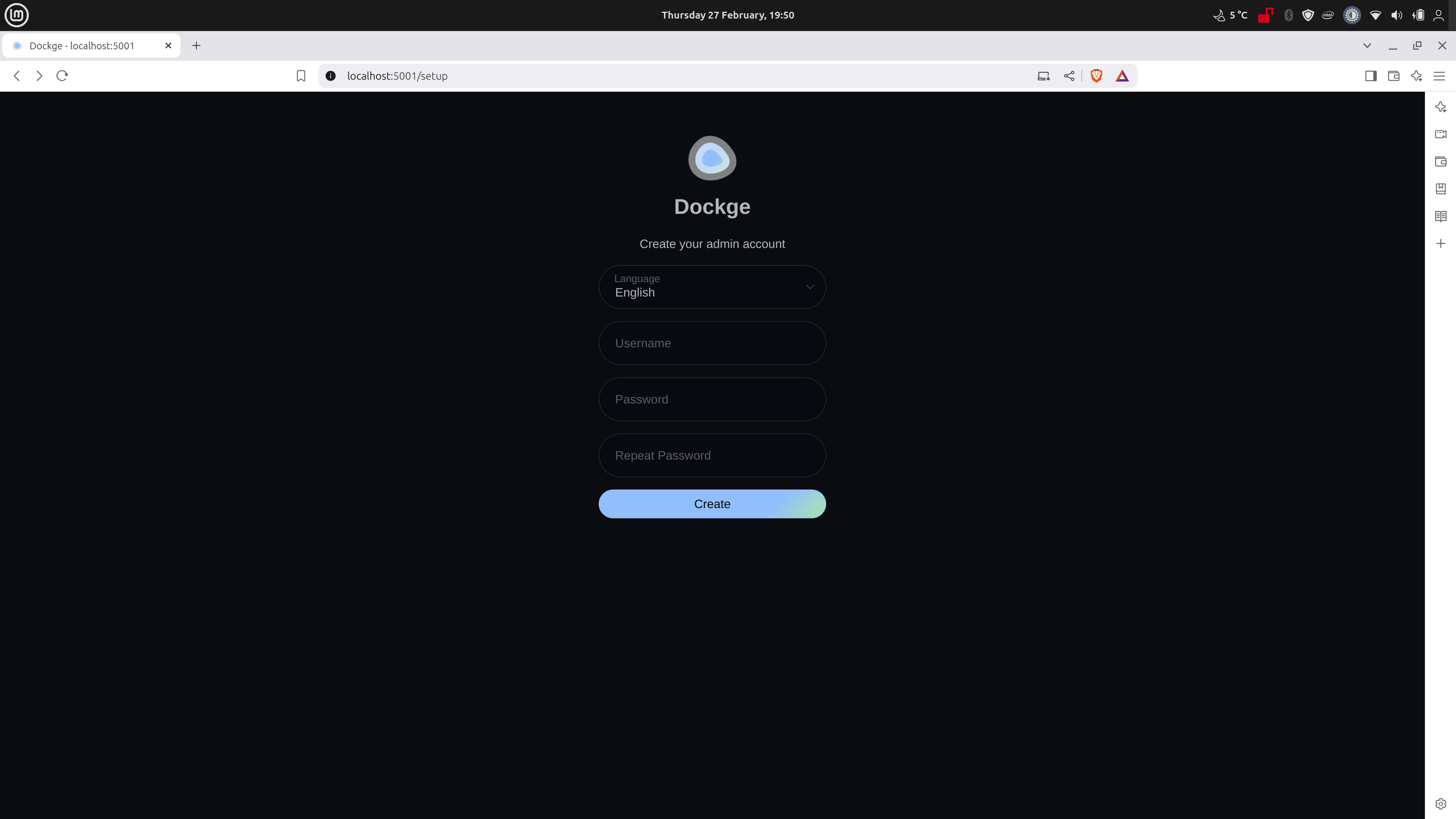

I then navigated to localhost:5001 and it shows this page again:
There is no dashboard with a drop down menu or anything else described. Do I have to complete the Dockge set up?
Is there a way to get rid of this Dockge and just have the normal Docker system? Or whatever the most straightforward way is of accessing it?
Thanks, I'll look into it to see if there's an easy way to bypass this for connections to localhost. For now, let's just get this running.
I have never used this, I only suggested since I saw that you had already downloaded and when I looked into it, it appears to be a nice and convenient way to handle it. I was not aware that they used authentication but it's all stored locally on your machine so there's no harm in doing that. I would recommend you to create an account, then you will have access to the dashboard.
