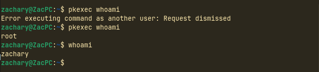

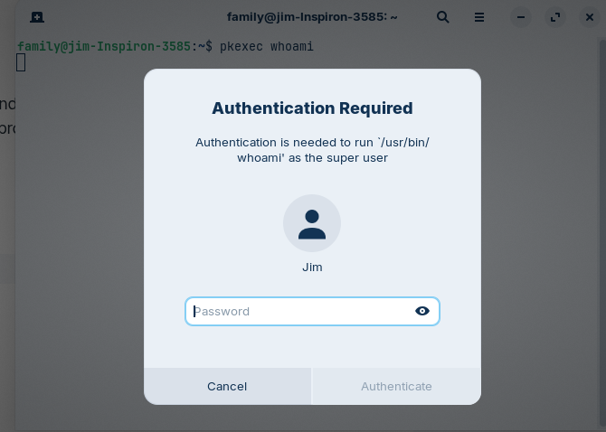

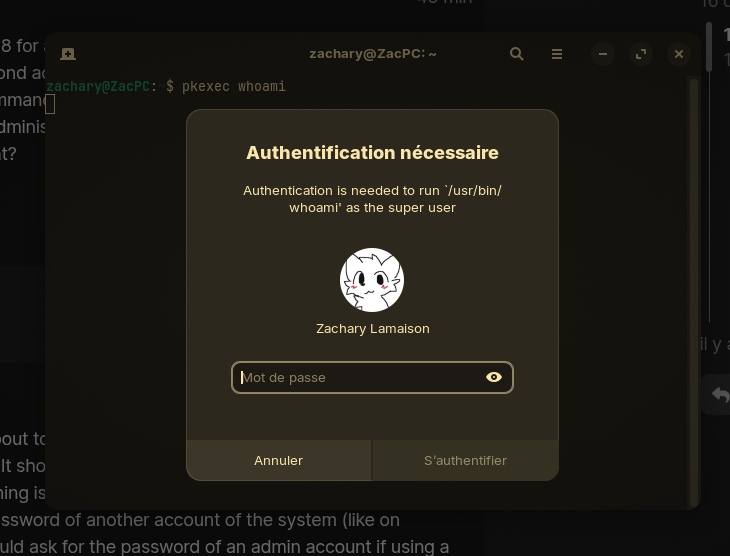

I dont know if what i'm about to say will work, but you can try replacing sudo with pkexec in your command. It should show a popup that app can use for asking for privilegies, but the cool thing is that i think if the current account doesn't have sudo, it will ask for the password of another account of the system (like on Windows, where UAC would ask for the password of an admin account if using a non-admin account).
Maybe i'm wrong or maybe this isn't the correct command, i'm not currently on my Zorin PC and cant test it.
After testing on my PC, i think pkexec should do the trick.

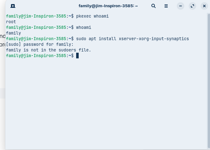

Tried this but still not working.
I tested it on Zorin live boot stick yesterday and it worked.
Use 'pkexec' instead of 'sudo' in the command, e.g.
pkexec apt install synaptic
pkexec apt remove evolution
or
pkexec apt update && pkexec apt upgrade
Yes because you still used sudo in your command.
In any command that starts by sudo, just replace sudo with pkexec.
For example, with the command you tried, the correct command would be :
pkexec apt install xserver-xorg-input-synaptics
