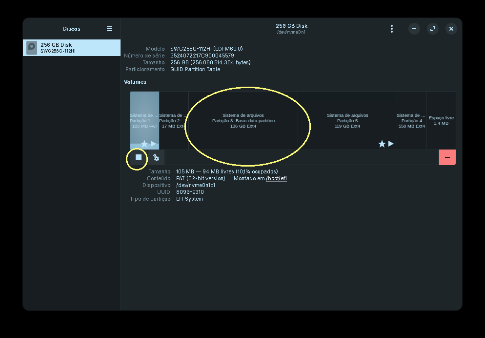

I've been a Zorin user for a long time. I've used it many times to learn Linux and have made several mistakes. Now I have this question, and I don't want to break my system, as has happened a few times through my own fault.
Anyway, I have a partition (3) that's unmounted and practically useless, as I have to keep remounting it if I want to write anything. Please find the attachments below (sorry for the Portuguese text), and I want to make it whole with partition 5.

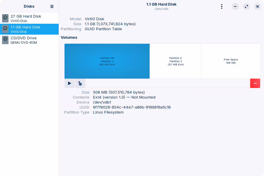

  2. Here's a similar example with a drive with 3 partitions, and I want to combine partition "A" and partition "B".

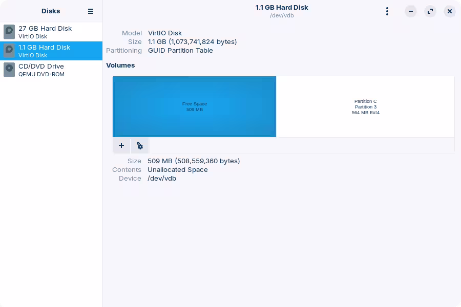

  3. Select each partition and click on the red button that's on the right hand side. This will delete the partition and mark the space as free to use.
  4. Select that free space and click on the + icon to create a new partition.

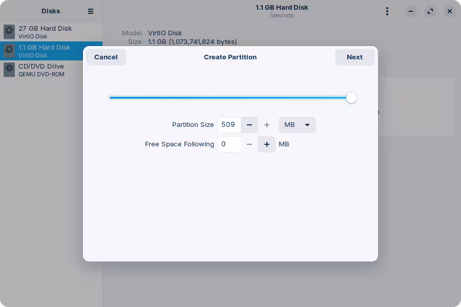

  5. You will be asked how much space you want to allocate for it, which by default will be whatever amount of contiguous space is available. Since you want to combine them, leave as it is:
  6. After that you will be asked what you want to call this partition and shown other details like the file system, etc. If you don't have special needs, you can leave the defaults as they are.
    After that, you should have partition (here's I've called it "AB"):

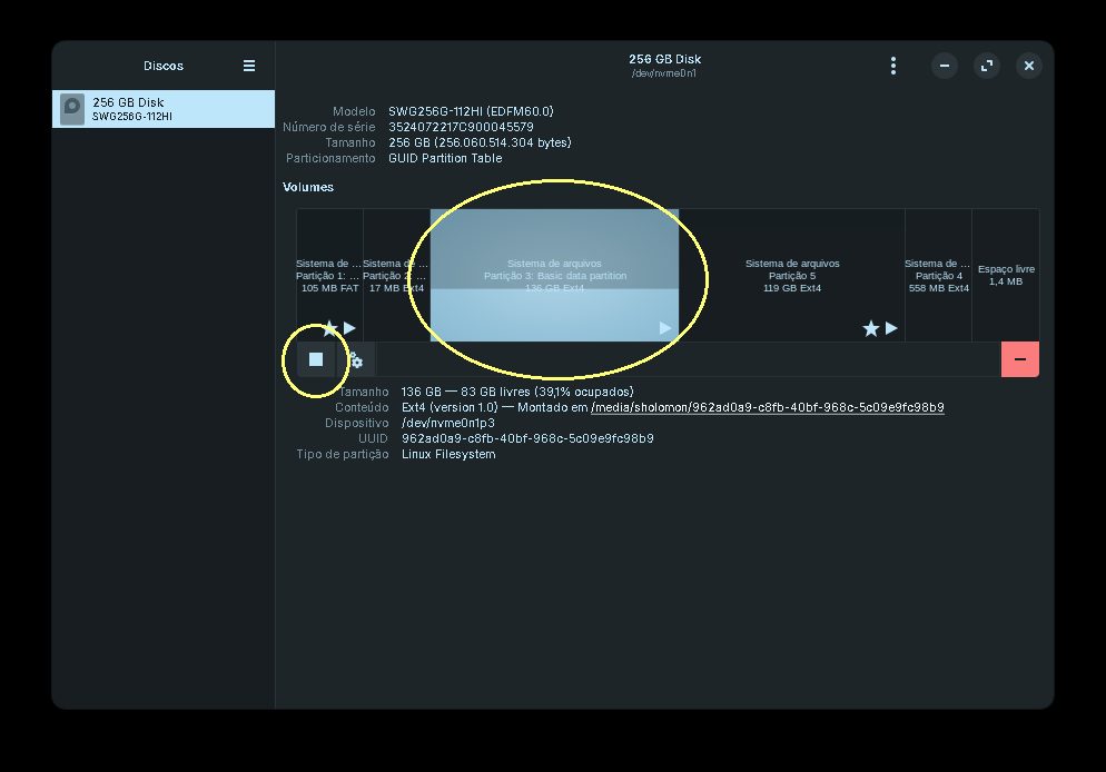

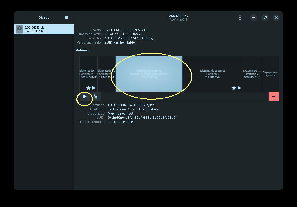

Thanks @zenzen , I understood correctly! My question was whether I could resize without losing the contents of the current partition. Therefore, I'll wait until the next Zorin version update to perform this procedure. Finally, is there a way to configure this partition to start mounted?
In gnome disks click on your partition, then on the cog wheel and select >edit mount options. There you can enable the partition to >mount at system startup.
Yes, friend! Thanks everyone, I just did exactly that. For now, my issue is resolved. Not only did I change the mounting option, but I also removed the notification from the tray. Once again, I'm very happy with the community.

Ah, I see. Well, the answer is yes but the order of the partitions is very important to avoid data loss. In your example, if you want to extend partition 3 using some space from partition 5 will lead to data loss on partition 5, because when you resize a partition you do so from the end of it.
Following my previous example, here's what happens when I try to resize partition C to make some room for partition AB:
Notice that I do have now some free space on this drive... but it's all the way at the end partition C. I cannot use it to extend partition AB, since there's some other used space in between.
I could delete partition C, resize my AB partition a little more, and re-format the remaining space again. But all the files from partition C would've been lost.
Back to your example, you could've resized partition 3 in a similar fashion: deleting partition 5, extending partition 3 a little bit, and then re-creating partition 5 out of the remaining space. This way, only the files from partition 5 would've been lost, but not the ones from 3.
There are ways around this... but it only gets more complicated and it's usually not worth it. Best to make backup of your files, re-draw the partitions and copy the files back.
