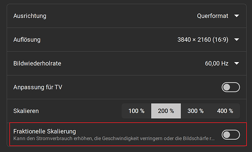

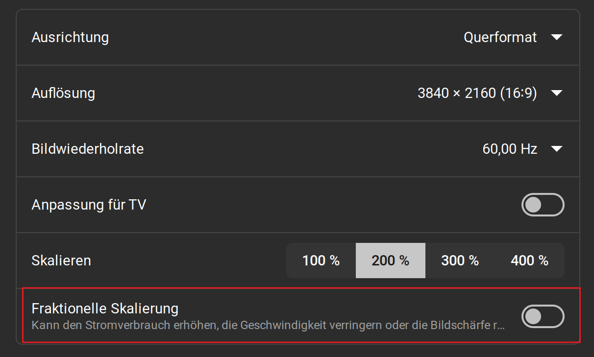

There is a simple Way to get that but You have to look if it works well. Go to Settings>Displays and activate Fractional Scaling:
Then You should get above a Dropdown Menu where You can choose 150%. But be warned: Fractional Scaling isn't well implemented and because of that it might not work well.

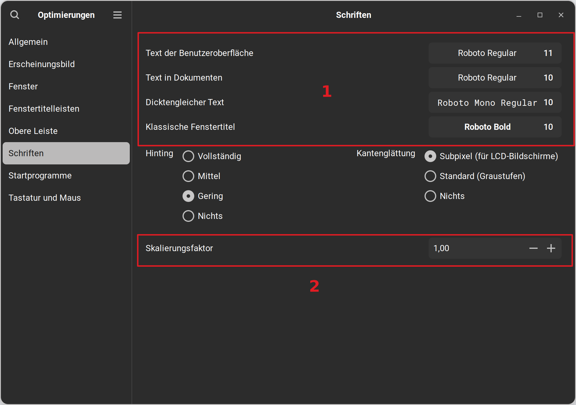

If You want bigger Font Size, You could avoid Fractional Scaling and instead scale the the Fontsize. to do that, open the Terminal and type sudo apt install gnome-tweaks to install the Gnome Tweak Tool.
After installing it, open it and go to the Fonts Tab. there you can set up the Fontsize (1) or increase the Scale Factor (2). You could play with it a bit to see if You get a for You fitting Result.
