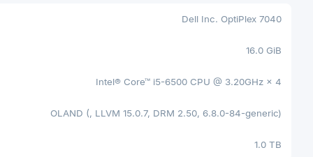

i looked into disabling the igpu and the only option was trying turning off multi-displays but since it didnt change anything i put it back on. i did read somewhere that if you set the gpu setting to auto that the igpu would get disabled automatically so i tried it. now zorin only has one gpu in the about section.
not sure why it still says oland instead of amd but i guess we're getting somewhere?
Please type in the Terminal the command sudo lshw -C video and post the Output here. This Command shows the Hardware for Video Stuff - including Graphics Card. OLAND could be the used built-in Driver for Your Card.

btw i ended up switching from auto bc zorin kept freezing on me. i guess using both graphics cards is the better option for now.
So, Oland seems to stand for the Graphics Card or the used Driver for it. Then it should be in Usage.
ok thanks, guess i can stop going insane over it
