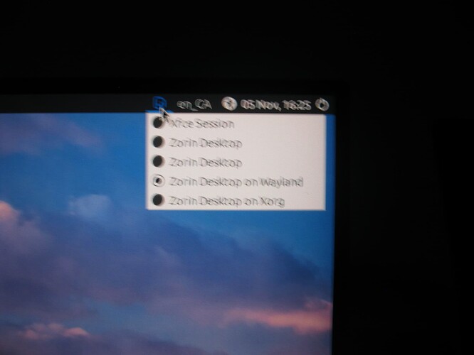

When I use the gear on the login screen, I now have a choice between XFCE, Zorin 18 Wayland, Zorin 18 Xorg (these I understand), and for some reason two additional ones labelled Zorin 18. The extras seem not to be Wayland. How do I get rid of them and should I?
My reason for thinking they are not Wayland is because they do not run Parabolic. For some reason, it only runs on the Wayland version of Zorin.
Could You make a Picture of the Choice and post it here?
A little blurry, but...
These are stored as .desktop files in /usr/share/xsessions/
Show your terminal output for
ls /usr/share/xsessions/
We can help you safely figure out which are supeerfluous.
steve@stevec:~$ ls /usr/share/xsessions/
xfce.desktop zorin.desktop zorin-xorg.desktop
steve@stevec:~$

/usr/share/wayland-sessions/
If you have duplicates in there... the extras can be removed.
steve@stevec:~$ ls /usr/share/wayland-sessions/
zorin.desktop zorin-wayland.desktop
steve@stevec:~$
You can see that there is a zorin.desktop file in each folder - and GDM is reading from both folders.
You can remove
sudo rm /usr/share/wayland-sessions/zorin.desktop
safely.
OK, now down to four. Why four? How should I best use them?
