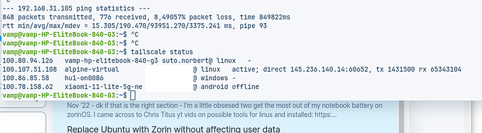

Somebody use Tailscale VPN? I affect that in Zorin is really slow. The native bandwith about 100/100 mbit, but with VPN, max 10 Mbit. On same network and same notebook, different system (Ubuntu, Fedora) it about 50 Mbit.
It use Direct connection, not DERP relays.
Edit:
Hmm seems the problem the Samba share... with iperf3 the speed are good:

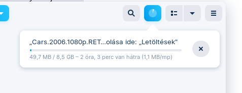

But samba copy:
Képernyőkép – 2023-08-25 16-26-05
I have never used Tailscale, but I did some searching on this based on your O.P.
Other users report very low speeds with direct connection over SMB.
The top question in most is "what is the latency?"
It seems you are correct in thinking SMB is where the bottleneck is.
Yes, possible that not the VPN are the "weak point".
i found this:
Edit: but it no so fast with cifs-utils... same speed, like nautilus.
