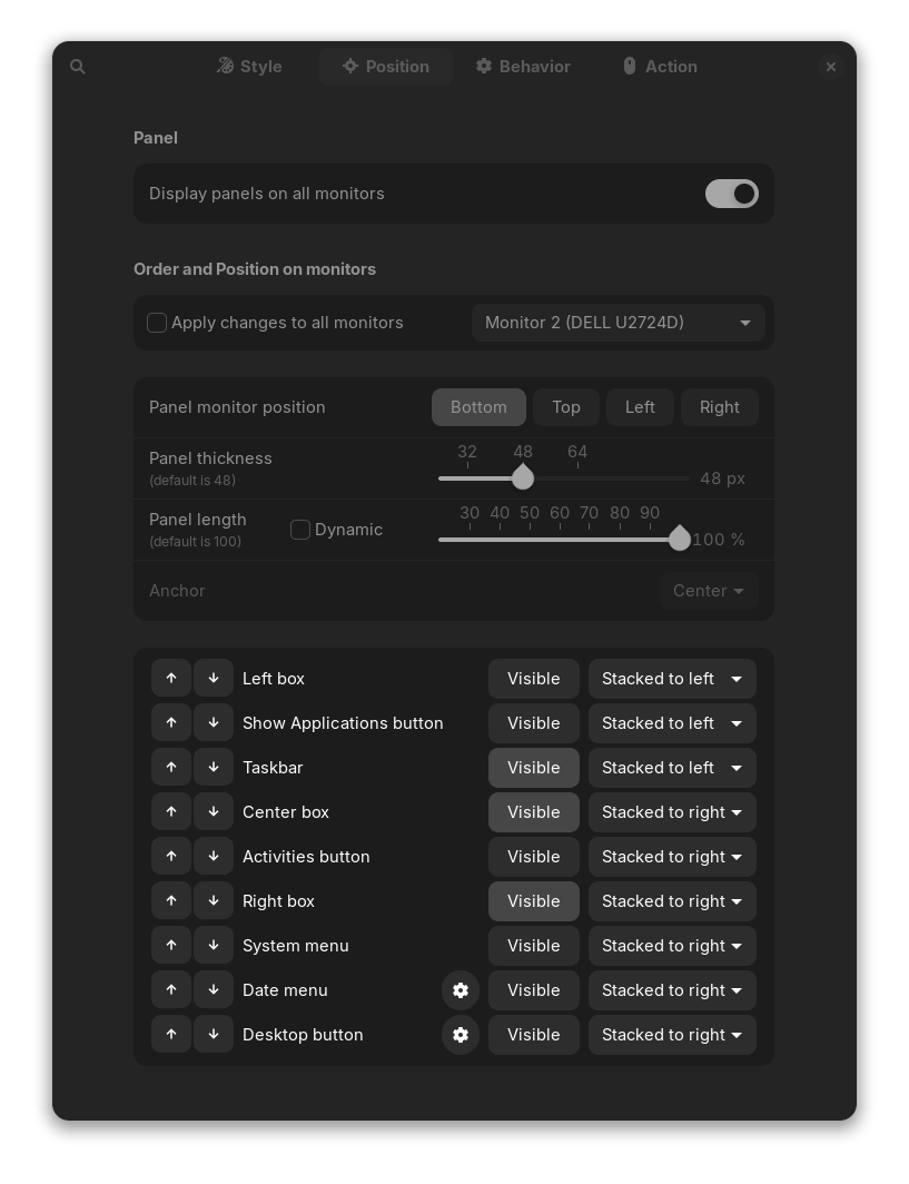

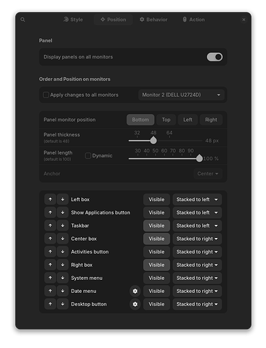

However, I'm having an issue with the taskbar settings not being properly retained over boots. I have 2 monitors and I like my appearance settings on the first option (not sure if it has a name) but customised: only showing running apps on the 2nd monitor, no clock, system tray or left box. Around every 3 - 5 boots these options will be randomly changed, no consistency at all. Items added or removed from either task bars. Sometimes there will be a system tray on both taskbars, sometimes no start buttons on either, desktop button added etc. Once in a while the entire appearance will have changed to no taskbars at all and a bar at the top only. I've never had these problems with KDE or Cinnamon.

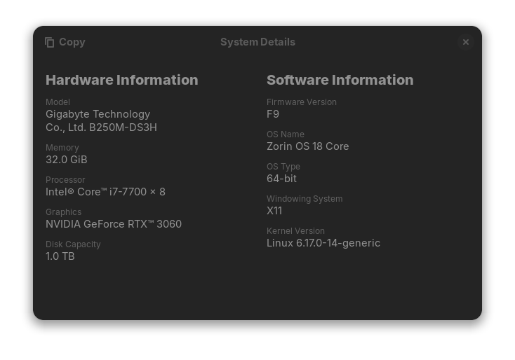

Specs:
Intel i7-7700
32GB RAM
12GB Nvidia 3060 driver version 580.126.09
2x Dell 27" 1440p monitors

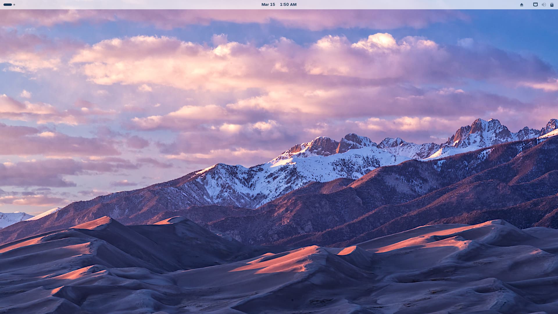

I have three monitors. My usual config is to have the taskbar at the bottom of all three monitors set to autohide. Tonight the taskbar is on top of display 3 only, no menu, no task bar, no right click to get to the taskbar settings. If I right click the desktop and access settings that way, the taskbar is still set the way it should be but the desktop is ignoring the settings. I do not have files ~/.config/plasma-org.kde.plasma.desktop-appletsrc and ~/.config/kdeglobals.
Edit: I just rebooted completely and no change. Taskbar in the wrong place, no start menu etc.
Display 3 looks like this:

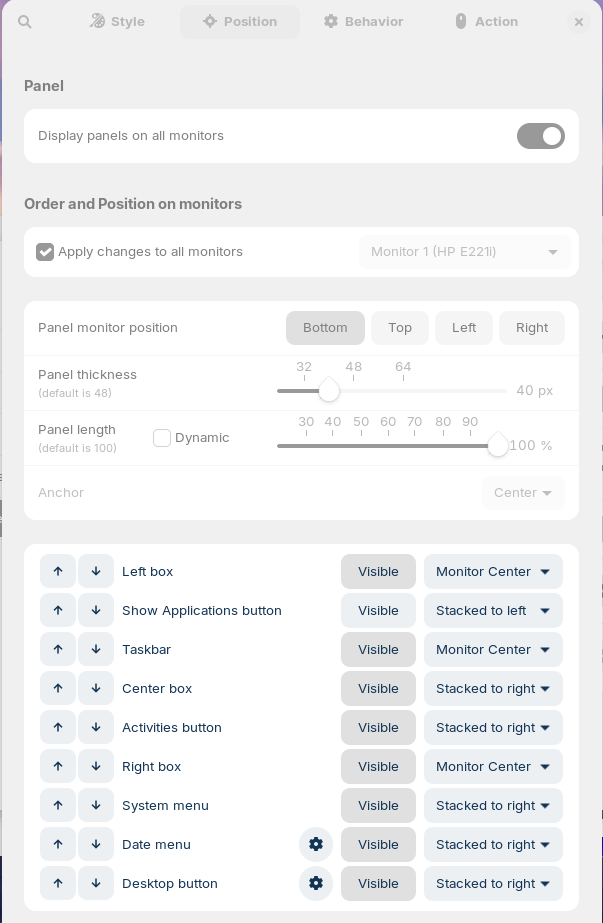

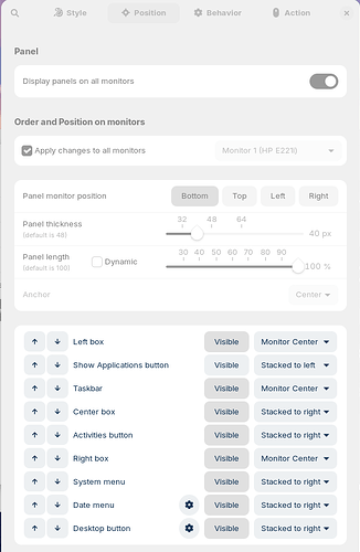

Taskbar settings are correct in settings, the desktop is ignoring the settings. The system menu and taskbar are both set to visible (doesn't show up well in the screen cap). All are set to "visible" except "Show Applications Button".
Did you try to switch to another layout in Zorin Appearance and then back to your favorite one?
Aha! That cleared things enough to reset it, thank you!
