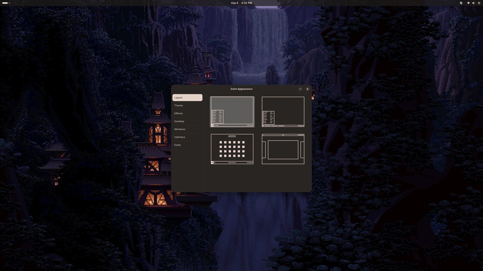

@Kikosemmek Have you checked Settings>Zorin Appearance to see if the screen layout option is still the one you have chosen and as expected.

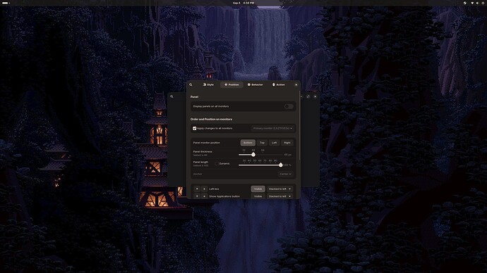

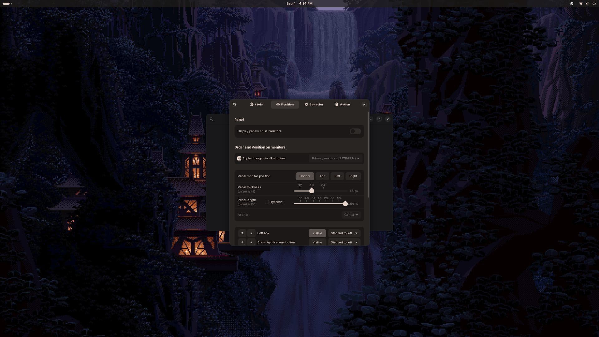

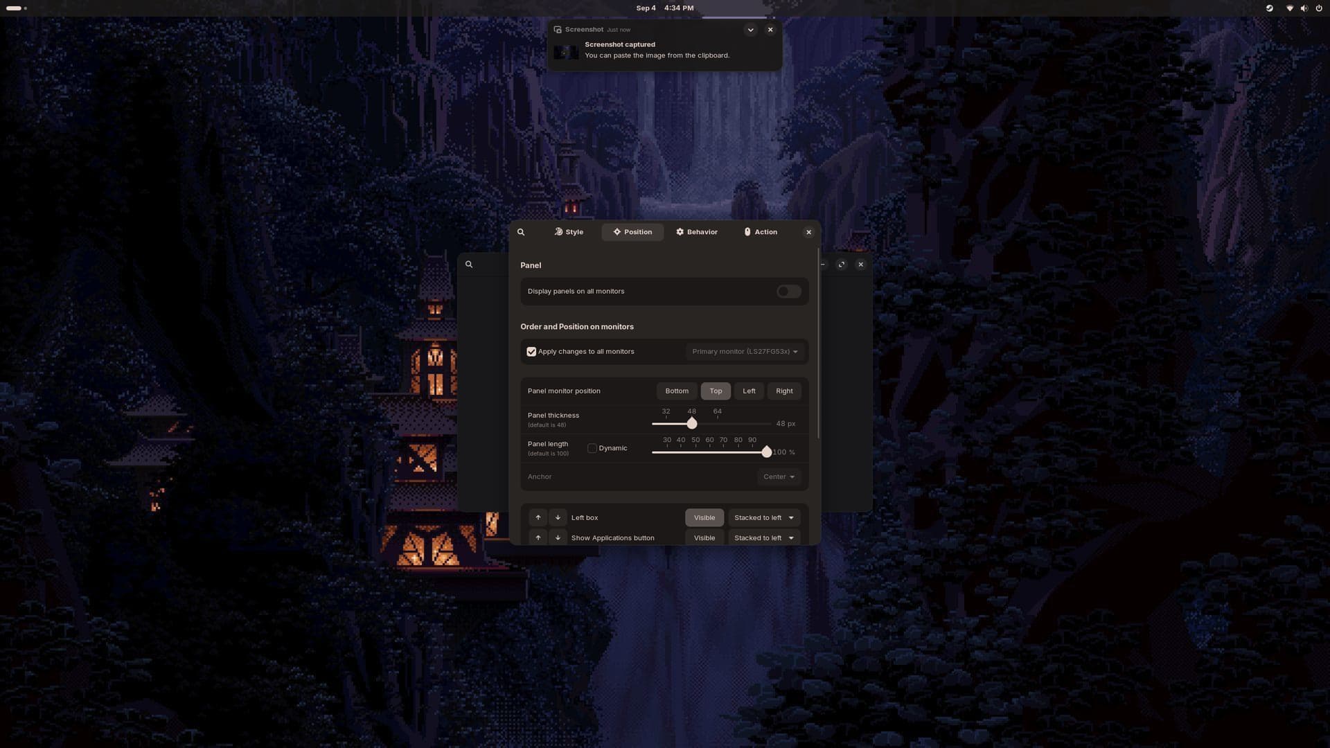

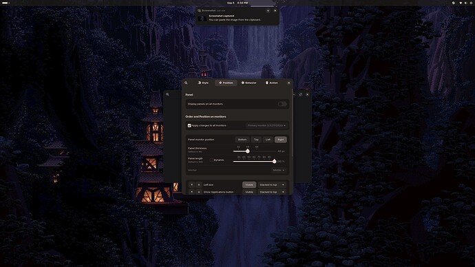

Could You make a Picture of it? It might be that it isn't acually the Zorin Taskbar. It might be the default Gnome Top Bar. To be sure with that, a Picture of it would be helpful.
Sure, here are some screenshots
I tried both of those things.
Disabling the Zorin taskbar seems to break the GUI and I had to reinstall it from terminal. On re-install, however, it's still glued to the top.
I tried the dconf terminal command and it didn't seem to do anything, still ignored all my layout picks in Zorin-appearance. Maybe I'm missing something?
Disabling the Zorin taskbar usually doesn't cause any problems; however, if you uninstall it via the terminal, the desktop will also disappear. For this reason, the option to remove the Zorin taskbar - as well as many other GNOME system extensions - is grayed out/not offered in the settings of the Extension Manager and dconf.
Your screenshot shows the gnome topbar at the top of the screen, not Zorin taskbar.
