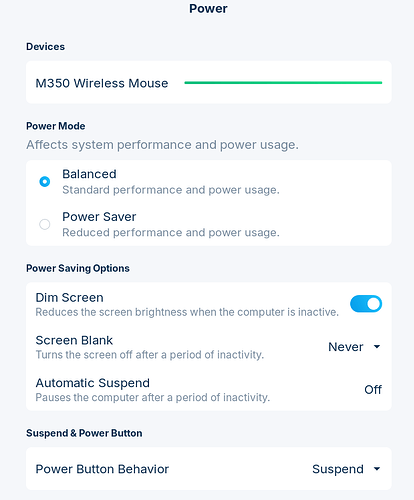

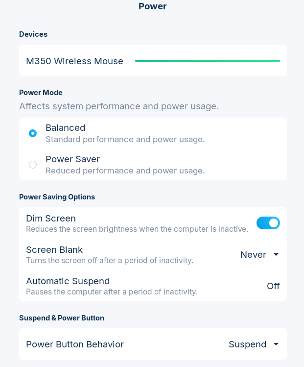

And here's a look at my power settings:
There's no real rhyme or reason to this. Sometimes the indicator displays after successive logins. Sometimes, not. I haven't installed any extensions or anything like that which might cause this to happen.

Is "Show Battery Percentage" enabled?
Is it also missing when you are on battery and not connected to power grid?
Is the icon only shown when battery is charging?
You could turn off-on "Zorin AppIndicators" at extensions.
You could try this extension that allows to set charging thresholds. But I'm not sure if it will solve the issue.
First install gnome-extension-manager then browse in this app for the extension you want to install and select gnome version 43.
Thanks for the reply. The Show Battery Percentage option doesn't appear in my power settings. Regardless, that doesn't explain why the power indicator sometimes displays and sometimes doesn't.
