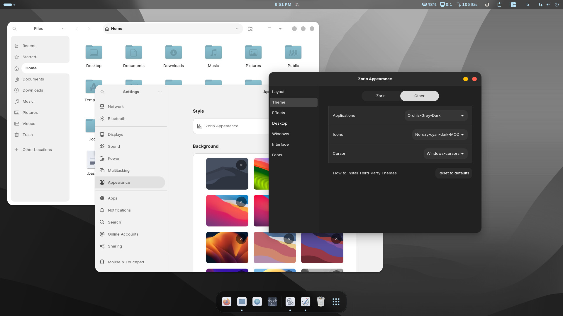

Theme changed but it doesnt show on apps
I recently changed machines theme to orchis, it changed on some applications but in the main apps like files, settings it just shows light mode, and in the top panel its still showing blue theme that comes with the system.
is there a solution to this?

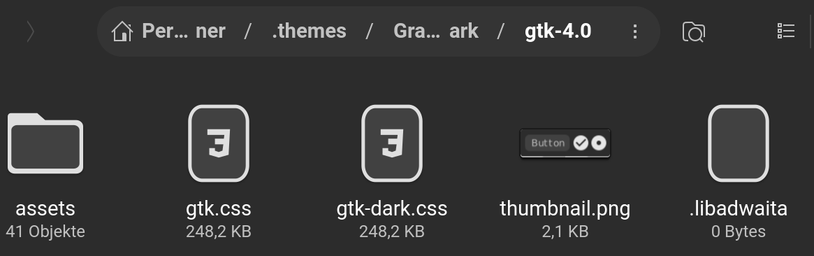

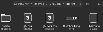

And to add to this something, too:
When the Theme is installed, go in the Theme Folder and there in the gtk-4.0 Folder and create an empty File called .libadwaita and then reboot and change to the Theme.
i dont know how i missed that,
it worked thanks
i fixed it, thanks anyway.
btw whats your icon pack it looks cool
It seem it is not requiered with zorin 18
Maybe it depends on the used Theme. I had to add it because it wouldn't look properly.
