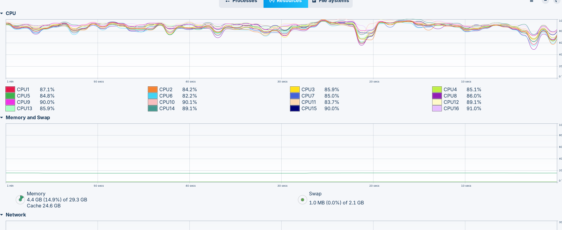

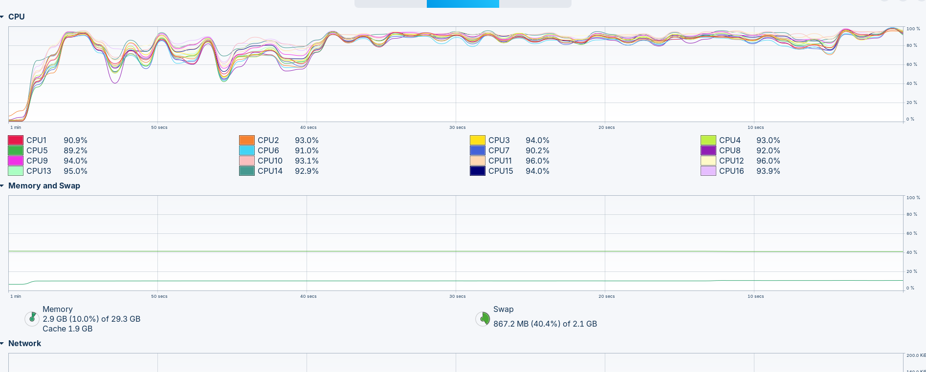

The first screen shot is before the mem test the second is after & the pc is doing same task in both shots
The Pc doesn't freeze or any other issues, It's just not using all available ram
