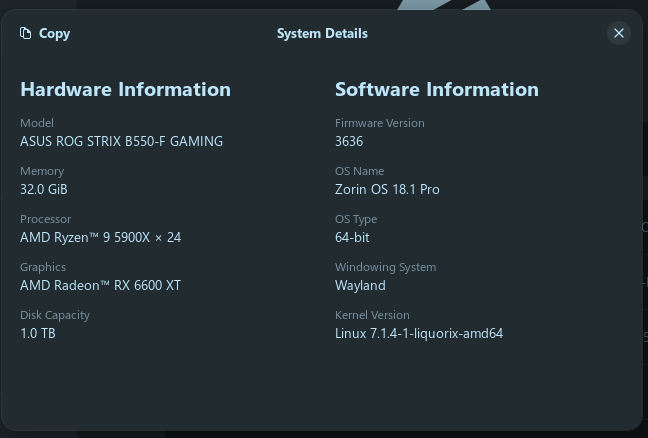

Hello all. as of late the newer 7.0.0.28 kernel has been abit lacking...to say the least there is a kernel that is stable and some here in zorin including myself are using it with zero troubles. here is the computer specs i have
this computer is a 2021 build and works fine on the Liquorix kernel current kernel is
this kernel is made for performance and optimazation. not sure how old of a computer this can be put on. maybe some who are using it can chime in a on thier builds and lets use know how well(or not well) its worked for you

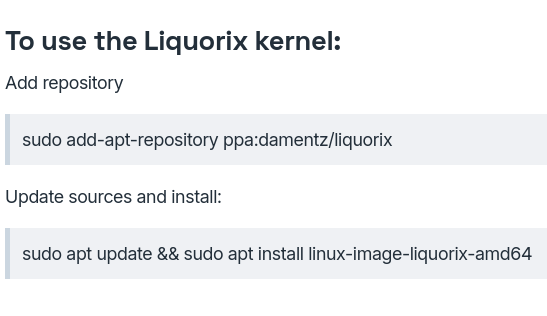

If you would like to try it and see if it works for you...here is the install info needed
Note: Secure Boot needs to be disabled before install..... :grin:
if you look at my specs you will see i am running it and have been since kernel 6.18.13 liquorix AMD64

I am using Liquoruix 7.1.4. (Think I mistakenly typed 7.14 elsewhere) with no issues. It is one I built myself. It has a Processor no longer officially supported by AMD, Ryzen 7 1700X with 8 Cores and 16 threads. Has 16 Gb of Corsair Vengeance Memory modules (2 x 8 Gb @ 3000 Hz) on an ASUS PRIME X470-PRO.
So from 2018.

The Secure Boot Thing is definetely worth an Info.
@wesoliv429: You should mention that in Your initial Post. It is important. If someone use Secure Boot, that could lead to Issues. Maybe write it before the Install Instructions Picture.

Instructions edited as per @Ponce-De-Leon suggestion..... :grin:
