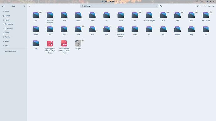

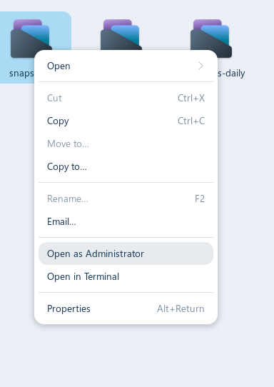

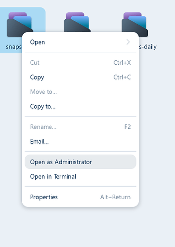

hmm yes you can.. i have mine being stored on the 2nd nvme but i think if you open files then other locations then zorin os you will see the timeshift folder open the snapshot folder in there i think you have the be in administrator to remove the ones ya want gone if you have nautlus installed you can right click the snapshot folder to see open as admin then open it and remove them

For the "open as administrator" function in the context menu of nautilus it is required to install the nautilus-admin package first with
sudo apt install nautilus-admin
