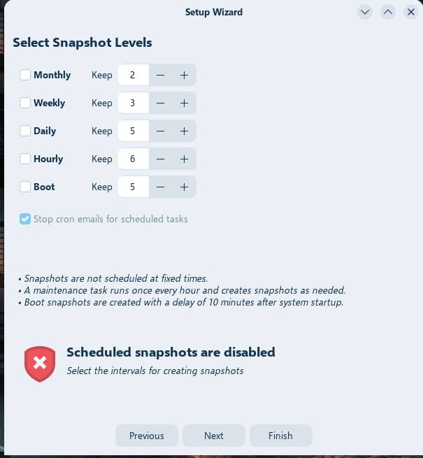

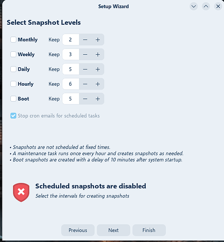

when logged in open timeshift then hit the wizard till you get to this page
checkmark the top box monthly keep 2 that will only keep 2 snapshots and not fill up the drive then the finish at bottom
I tend to just delete the one there and make a new one every 2 weeks to save space. not sure if the monthly works proper at deleting over 2
I just change daily from 5 to 3. What happens when I run it, the first snapshot seems to be always present after initial install of OS (I am referring to PCLOS Debian as it is included at point of OS install), then only additional 2 or three are present each day. It does not keep each of the daily snapshots (from my personal experience).

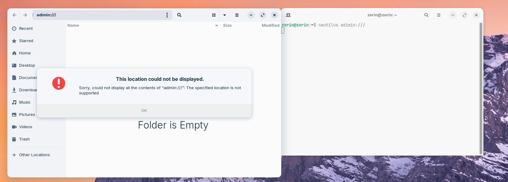

Can you delete the timeshift snapshots when you enter admin:// in the topbar for the path in nautilus (in live session) and then navigate to the directory you want, e.g. other places > select your internal drive with Zorin > home > your username > timeshift.
The admin command elevates you to root.
I was unsure what Nautilus is, I did a web search and it is the File Manager app, yes? I tried entering "admin://" in the search bar of the file manager and got no result. Or do you mean something else?

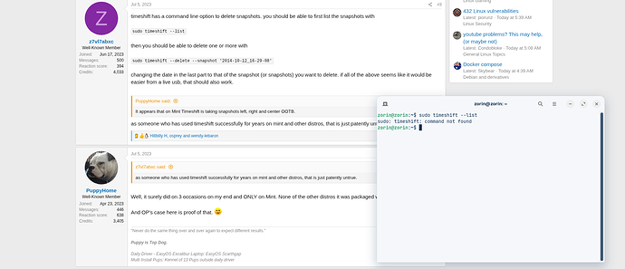

Hi, perhaps the solution with 4 votes here gives a clearer picture, you need to add the path after admin:
Additionally, this is why I keep a copy of a distro that can run in live mode that has timeshift as part of the OS, Linux Mint:
Yes, nautilus is the default file manager of Zorin Core.

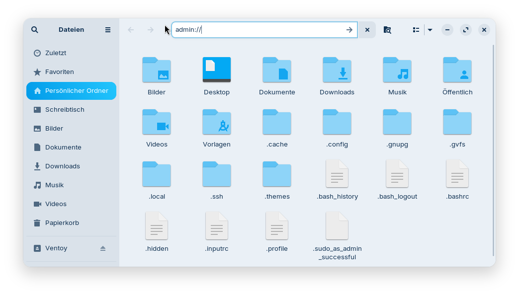

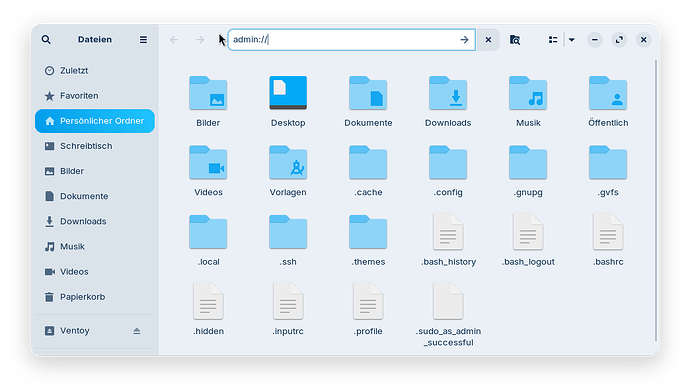

Click on the path field or press ctrl+l, then type admin:// and press enter. You are prompted for the password, and then nautilus is opened with root rights in root directory. I made a mistake before. You need to go to other places to select your internal drive and then there go to the home folder.

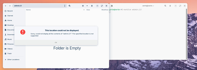

and I tried this as well from Linux.org link
It did not work OR am I still doing this incorrectly?

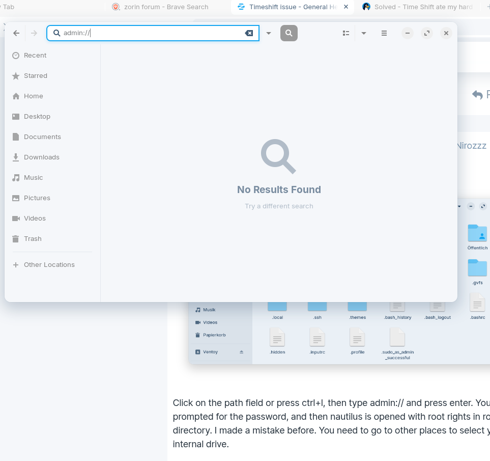

You have entered it in the search field. That does not work. Leave the search (close nautilus and open it again, and enter it in the top bar in the long field where usually is shown the path. When you open nautilus, you see "personal folder" or "home folder" there at the top middle of the window (I am not sure what the english name is). Click there.
Don't click on the magnifying glass icon.

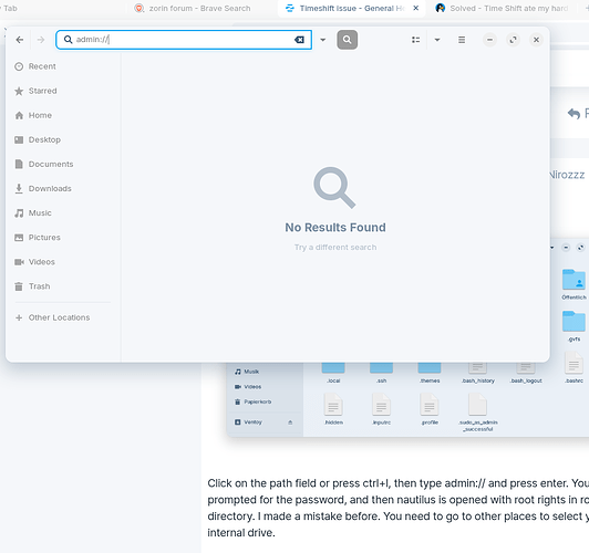

I tried this several times and it turns into a search each time?
