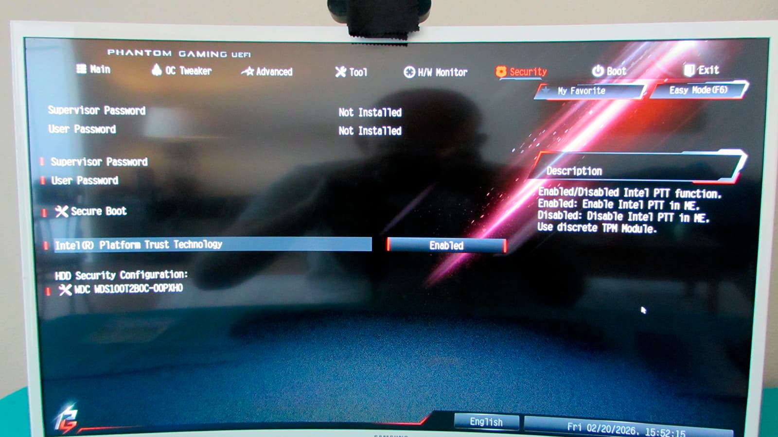

Can You maybe post some Pictures of Your BIOS with the Options? So, we could take a Look at it.
Thanks for the response. I'll get the screenshot posted tomorrow.

Here is the photo. Sorry for the quality, it was the best I could do. The computer is a Powerspec G434, which I believe is a 2019 or 2020 model. Here is a photo of the UEFI. Whether the Intel PTT is enabled or disabled, in either case the setting is "Use discreet TPM Module". I've already been assured that if I don't boot into Win 11 (which I never do), then the TPM won't cause any mischief and it's a white-knuckle experience to go poking around in the UEFI and change settings.

The Intel PTT will be a BIOS 'firmware' version of TPM, in much the same way my ASUS BIOS got an update for TPM as a firmware option. 'Discrete' means you have a TPM 2.0 chip installed. On Desktop motherboards from 2019 like my ASUS PRIME X470-PRO, the TPM 2.0 chip was never shipped but they usually came with a TPM 2.0 slot on the motherboard.
