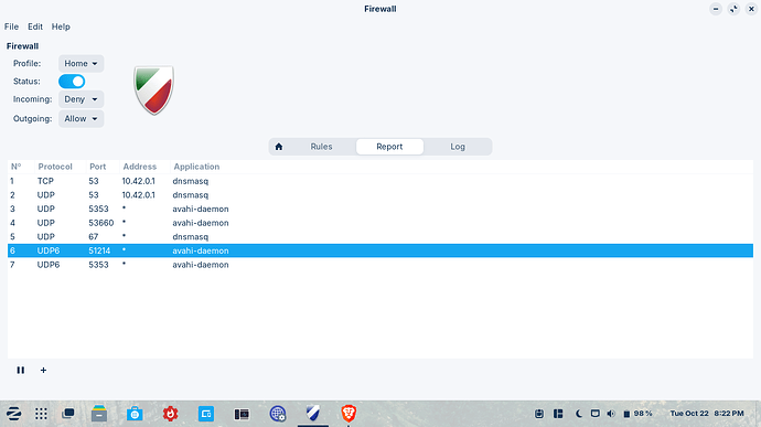

I tried each of the mentioned new rules. I took screenshot before and after turning on hotspot to identify what becomes active(the new rules) in UFW for the hotspot. Then I tried these new rules for the ports one by one.
Interestingly, allowing port 53's udp and tcp both or one by one did nothing. But when I added port 67 udp port, the android device could connect to the hotspot but doesn't get internet access. I have attached relevant photos:
Before activating hotspot:
After activating hotspot:
So the ones belonging to port 53 udp and tcp, port 67 udp of application dnsmasq are responsible for hotspot in my case.
Current condition of connecting to the hotspot from my android device:

That all looks fine to me... the rules clearly state that all incoming traffic to wlp2s0 is allowed, and you can connect to the hotspot, which proofs that it works, up to a point anyway.
On your phone, when you tap the settings icons for the TP-Link access point (after you've connected to it), does it assign an IP address? For example, 192.168.1.50 or something similar?
And, have you test the connection just in case it actually does work despite the message?

I tested browsing, youtube etc with that connection. It doesn't work.
The hotspot does show an IP adress but it shows IP settings as DHCP. Then again the IP address is a bit weird per say. It's 10.xx.x.xxx. Although I don't know if the settings is showing the android devices IP address or the hotspot's IP address.
That is weird. IP addresses starting 10.xxx.xxx.xxx are usually reserved for business networks. Joe public IP addresses start with 192.
Yep. pretty weird. I can confirm that I am not in a business. Fun fact, my ethernet's IP is 192.xxx.... . Idk why the hotspot gets a business one.
I wonder which one matters for @zenzen 's question. The router's IP address or the android device's IP address

I guess activating the hotspot runs dnsmasq. I don't see dnsmasq anywhere else except for that. But I don't run it on my own wish. I don't even know what dns masq is.
dnsmasq is a service that can, among other things, assign IP addresses to devices on a network. And yes, the Network Manager spawns it's own internal version of it, so that's expected. I wanted to check in case there were two separate instances running that may be in conflict, but that does not seem to be the case.
