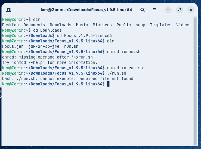

Unable to get "run" to execute in terminal
I guess I need some help in figuring this out why run wont execute
here are 2 screen shots with the commands I am useing I am trying to get away from win 11 and their multiple login B.. S..
a little help would be nice and I am a rank beginner at Zorin {Linux} 18.1 have spent hours just getting this far. hopefully with some help I can get it to work on Zorin
Have tried the chmod +x run command and the ./run commands
no luck
run.sh cannot execute error|674x499
Tks
Ken

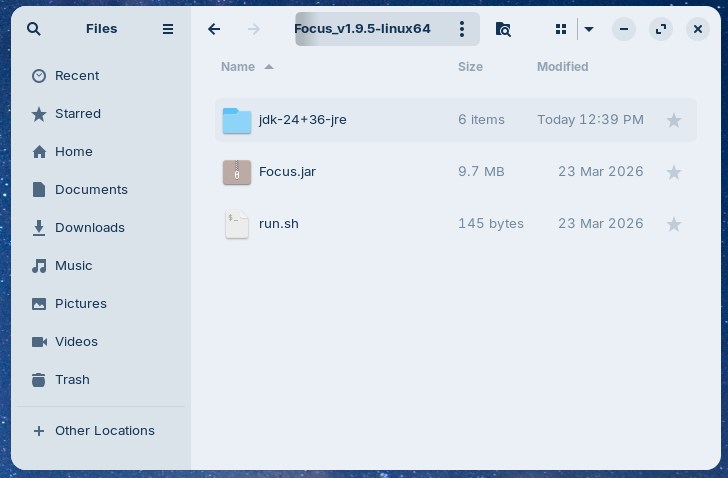

Enclosed the 2 screen shots , 1 of where the run.sh lives and the other shows the directories and the "error".
the chmod +x run.sh seems to be accepted as proper syntax to run .

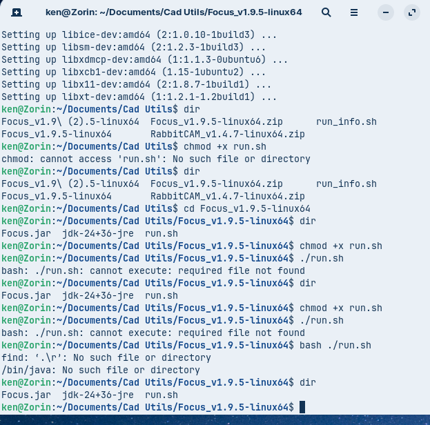

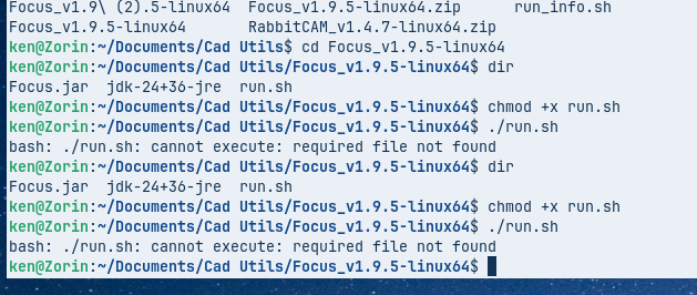

another try still with error and of screen shot.
I think i did it right I tryed it twice with the same outcome ..but?
tks
Ken
Okay, try it with
bash ./run.sh
as @LucasZorinNL recommended.

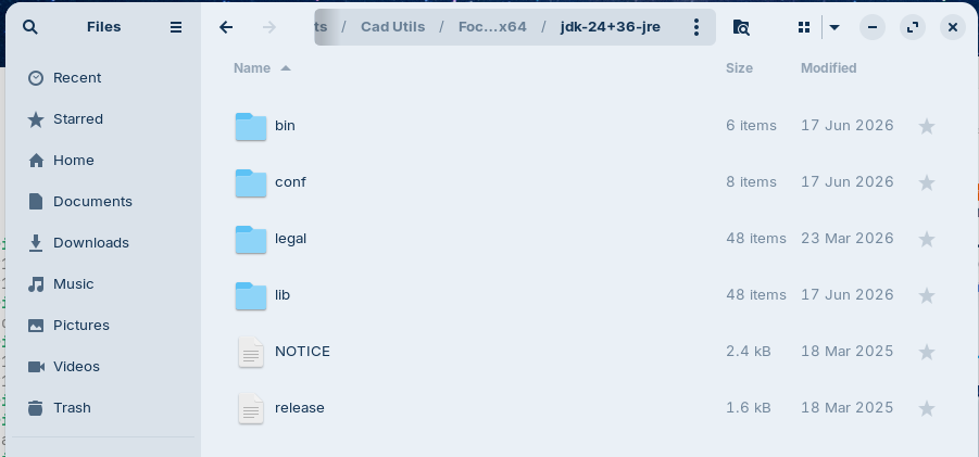

What is in this jdk-24+36-jre Folder?
I just noticed that you have a space in your folder name "Cad Utils". I don't know if that's the problem here, but in Linux, it's better to avoid spaces in the names of files and folders. You can use an underscore _ or a hyphen - instead of a space.
Ok here are a couple more screen shots of what is in that folder and the "no such file or dir..."

Could You show the Content of the bin Folder?
