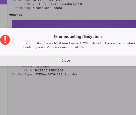

When you select the drive in the app disks and press the play button :play_button: to mount the drive, does that work?
i tried that and got this message

well if im seeing it correctly its a boot drive format NTFS/efat/HPFS
I see this, too... But if it is "dirty" by a forced unmount, the system may be unsure what format it is.
@zorinnewbie2, can you open a terminal and run:
sudo blkid /dev/sda1
That should show the format. If it shows as NTFS, with it plugged in, light on, can you open a terminal and run
sudo ntfsfix /dev/sda1
If it shows exFAT or if it shows EXT4, instead run:
sudo fsck -f /dev/sda1

THANK YOU, I did that and it worked
