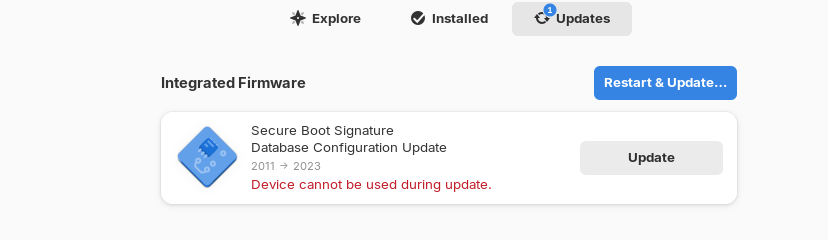

Unable to remove error in updates -
I have tried everything from rebooting to use of some code provided by one of the Zorin facilators on this platform. I have NO idea why this appeared two weeks ago

Sadly it failed as follows georgy@georgys-zorin:~$ sudo fwupdmgr update
WARNING: UEFI capsule updates not available or enabled in firmware setup
See PluginFlag:capsules unsupported Β· fwupd/fwupd Wiki Β· GitHub for more information.

Perform operation? [Y|n]: y
Writing… [****************************** ]
Successfully uploaded report
failed to write-firmware: failed to write DBUpdate3P2023.bin: failed to write data to efivarsfs: Error writing to file descriptor: Permission denied

It seems your EFI (BIOS) Version does not allow updating by this method.* So it is not Gnome Updater, fwupdmgr (Or Zorin OS) that is the fault, but the EFI operating system itself.
In you BIOS Settings, do you see any options for Capsule, Manufacturer Updates, or similar?
If you are not dual booting with Windows OS, you also can consider solving the issue by disabling Secure Boot.

This computer dates from about 2012 or 2014. You will not see EFI variable tables on it, much less a new firmware update.
So, I would suggest in your BIOS, turn Secure Boot to Disabled. While that may sound scary coming from Windows OS, Secure Boot is operated for and signed by Microsoft. It is primarily applicable to Windows OS which you are not using.
