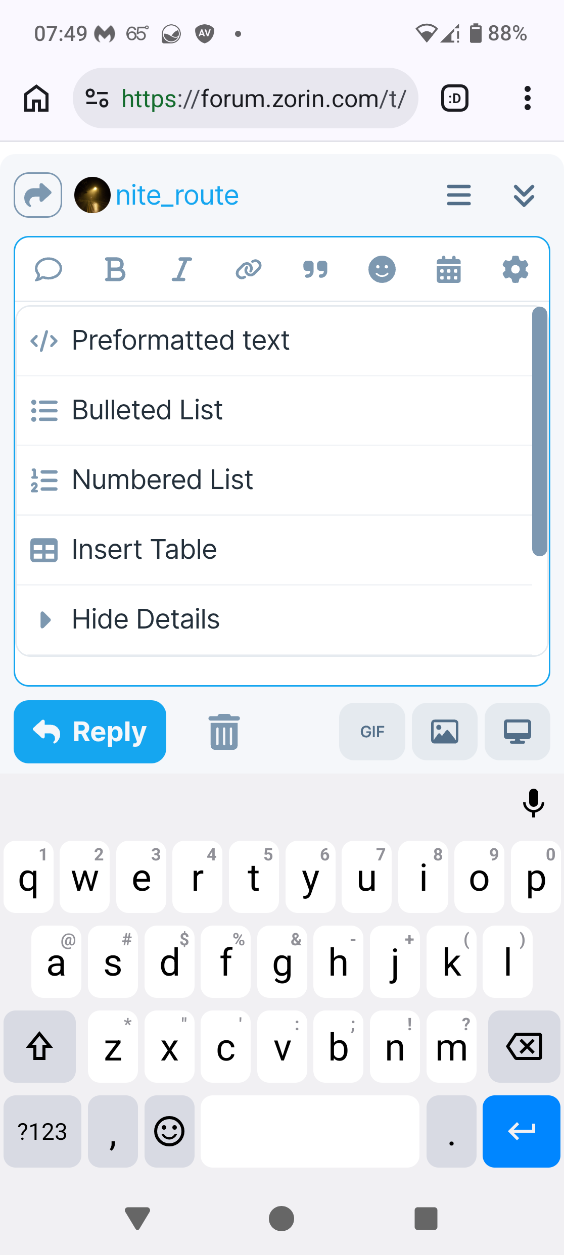

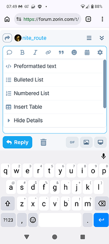

Hi, can you use the preformatted text option when posting code? It makes life easier for posters to copy and paste into the terminal.
:wink:
