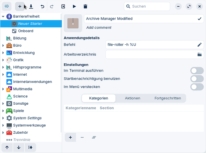

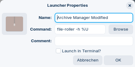

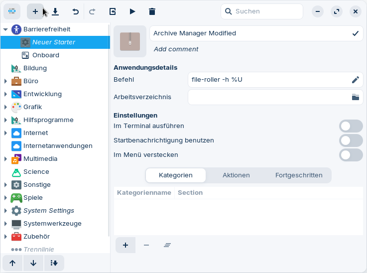

Open alacarte (Zorin Core) or menulibre (Zorin lite) - you can instead also right-click on the Zorin start menu icon and select "edit menu" - and then create a new launcher.
As name choose a name you like, e.g. Archive Manager Modified, and as command file-roller -h %U
Also set an icon you like.
It looks so:
Zorin Core:
Zorin lite:
Then save your new launcher entry and right-click on your archive file > properties and set the Archive Manager Modified as default to open the file type.

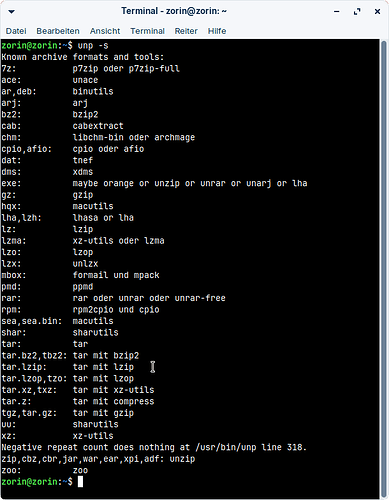

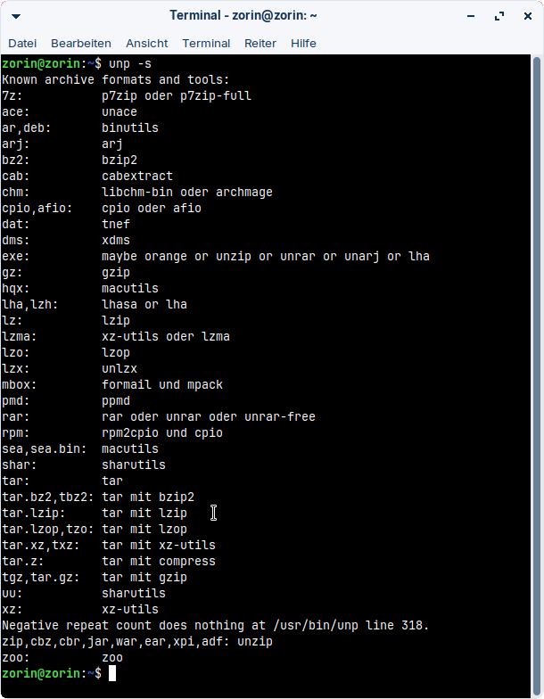

I found another good tool, very small, named unpack, which is very fast and doesn't create a new directory when extracting the archives. You can install it with
sudo apt install unp
As custom command for extracting archives in Thunar set "unp %f".
It supports many archive file types:
Another command line tool is unar, which also can handle different archive file types (sudo apt install unar), or patool (sudo apt install patool).

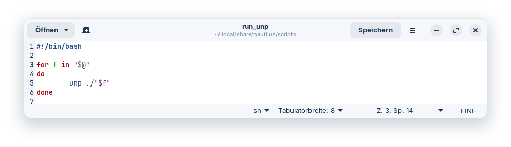

For Nautilus in Zorin 17 I found a solution to extract archives fast with the unp tool, but it is not very handy (you have to do more steps than with "extract here").
I created this script at ~/.local/share/nautilus/scripts,
and when I right-click on an archive file and select scripts > rununp, the archive file gets extracted.
You can replace the unp command in the file with other commands you like, e.g. aunpack to use the atool instead.
