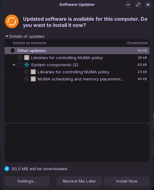

for some reason these 3 wont update. it starts updating then it just closes without any error message. see screenshot
These could be hold-back Packages. That wouldn't be unnormal. These can have Dependency Issues or othere Reason that these would be hold-back for now. Can You type in Terminal sudo apt update && sudo apt upgrade and post the Output here?

3 packages can be upgraded. Run 'apt list --upgradable' to see them.

The following upgrades have been deferred due to phasing:
libnuma1 libnuma1:i386 numactl
The following packages will be DOWNGRADED:
firefox
0 upgraded, 0 newly installed, 1 downgraded, 0 to remove and 3 not upgraded.

had to remove all : from the https links because i cant post more then 5 links. just realized that this downgraded firefox, which might be the same problem the other guy posts about not being able to update firefox. i installed zorin with complete new harddrive about 2 days ago.
Don't worry, and read this:
but then it would be a great update to throw a message for the users. something like "update will be available soon" so everybody knows whats going on + please please please, always write a short explanation in like 1-2 sentences, not just a "read this followed by a link" so that other users with the same problem find the answer fast. ... Problem solved. threat can be closed.
