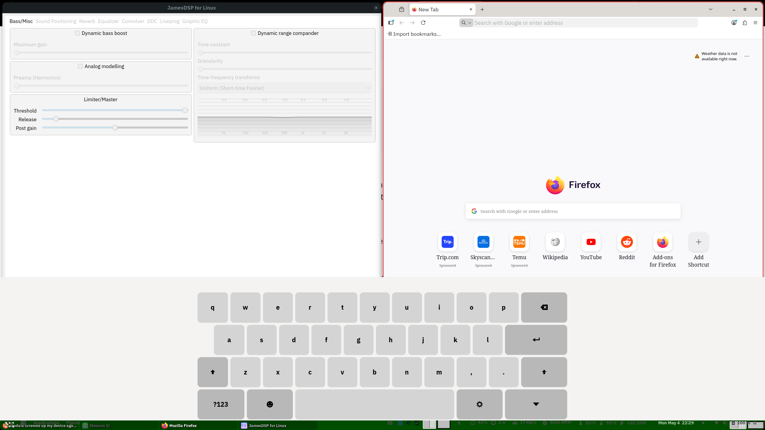

-the gui is "set to default"

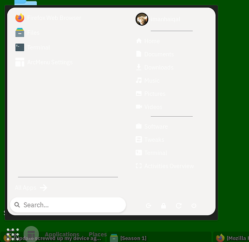

-theme is white but so is the the font and text. I cant see or read anything.
-because everything is set to default im having a hard time getting somewhere in this unfamiliar ui's.
-i use gnome to customise my desktop but i think its buggy, i set it to disable and enable and restart gnome but it doesnt change much other than making things worse

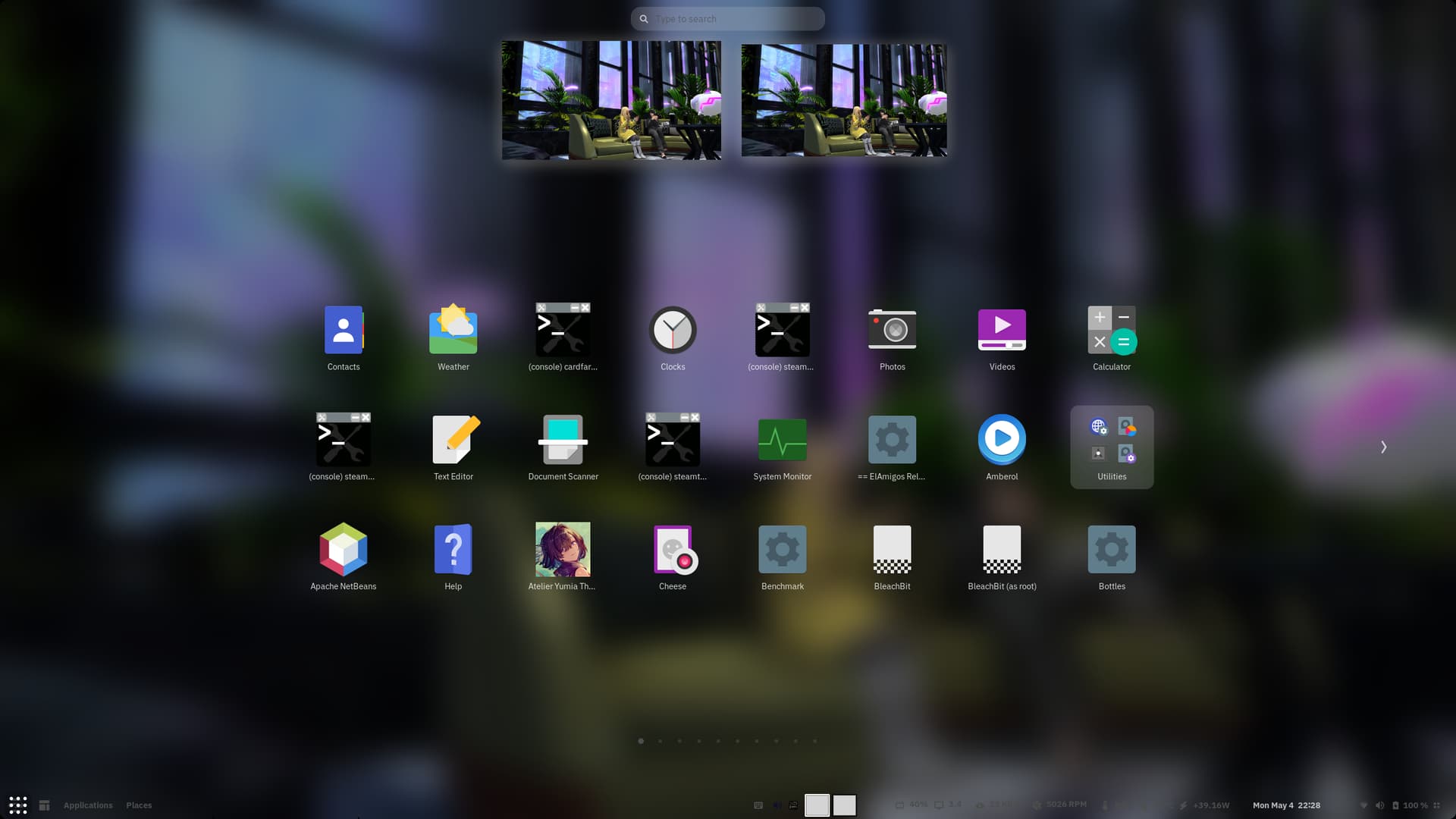

trace of what it was can be seen

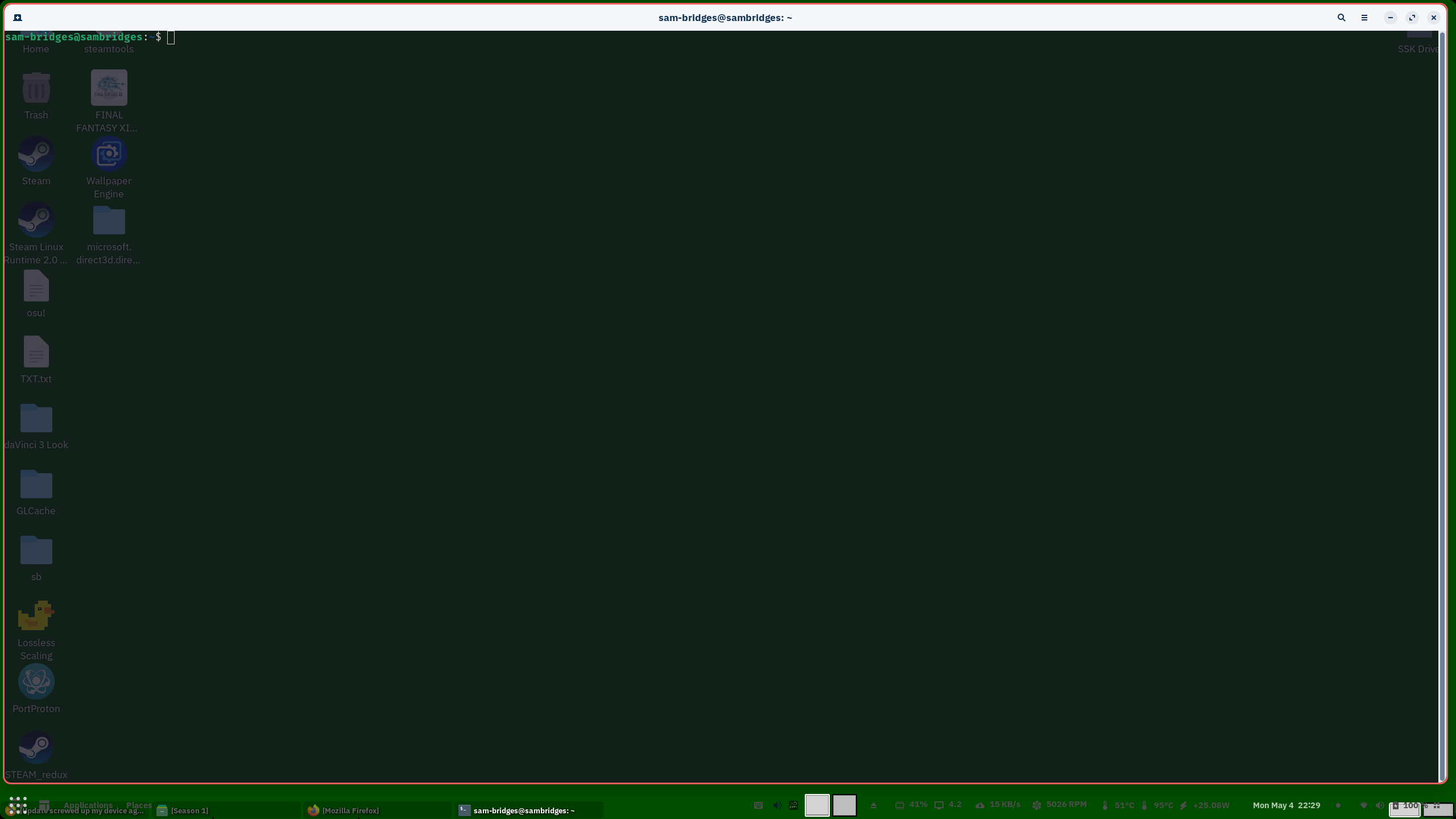

-taskbar,theme,icon is different and becomes invisible when hovering over cursor. of which my custom animated cursor is also set to default
-every window is forced maximise when in windowed mode and are not resizable. they also have this red border

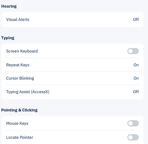

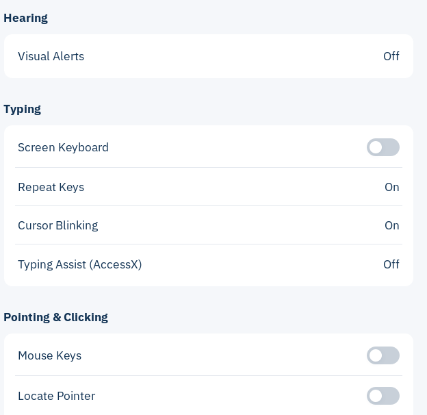

-the virtual keyboard keeps prompting whenever i click any text insert box even after i turn it off in the setting

[everything changed. my start tab is on top left previously bottom left. the theme is set to default white and the text is also white making things incomprehensive. and a virtual keyboard keeps popping when i want to enter text]

4. Disable the virtual keyboard (this one is simple)
That popping keyboard is from accessibility getting toggled.
Turn it off:
gsettings set org.gnome.desktop.a11y.applications screen-keyboard-enabled false

Update
apparently Gnome is breaking everything and it becomes fine when i turn it all off.
However, my taskbar is set to top and not the bottom which i dont like.
When i change the layout in Zorin Appearance it turns Gnome back on where everything breaks. Thoughts?
