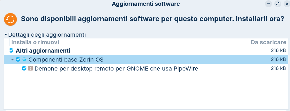

Even though I've configured updates to be notified immediately upon availability, I'm not actually getting any messages. I can only see them manually from the software and install them.

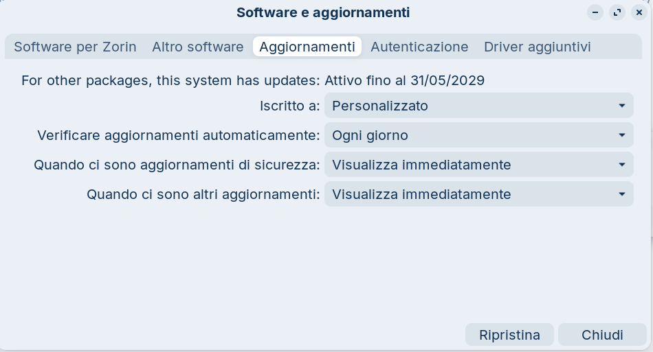

The Software Updater, okay. Could You post a Screenshot of how it is set up in Software & Updates?

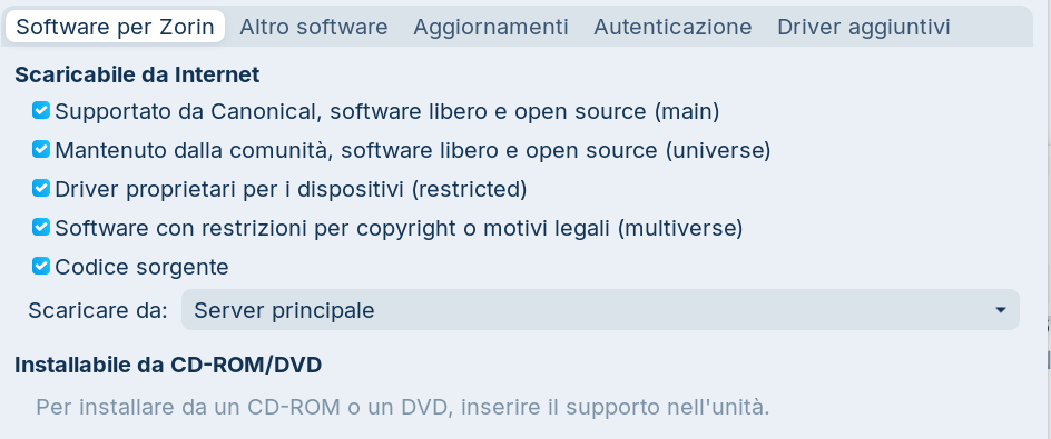

Can You on the first Option set it to ''All Updates''? And have You on the Tab ''Software per Zorin'' the Source set to Main Server?
No non è possibile impostare "tutti gli aggiornamenti" ma solo "personalizzato". No non avevo impostato il codice sorgente sul server principale. Ora l'ho fatto
Okay, then I would suggest to observe it for a While and see how it behaves now. Besides that: The Automation of showing the Updates depends of Course from the Background Process of searching for the Updates. So, when the Timing isn't good, it might show not immediately.
