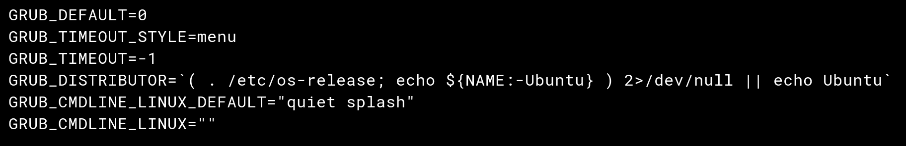

You can activate GRUB in Zorin, too. Open in zorin the Terminal and type
sudo nano /etc/default/grub
There You will see this white Textblock:
(In Your Case it could look different)
Important here are the Lines 2 and 3. Check that GRUB_TIMEOUT_STYLE is set to menu and GRUB_TIMEOUT has a Value over 0 or is set to -1 and then the GRUB Menu should appear.
When made the Changes press ctrl+o to save, Enter to confirm and ctrl+x to exit. Then type sudo update-grub to make the Changes affect. Don't forget that! Without it, it will not work. Then reboot and You should see GRUB.
