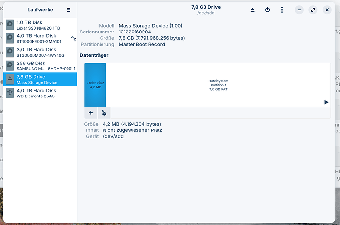

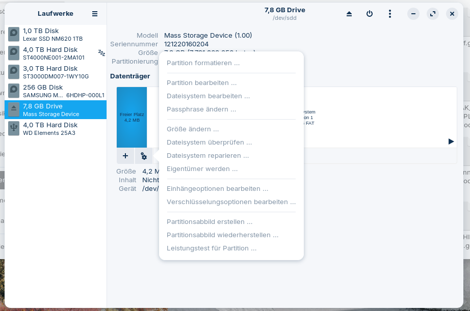

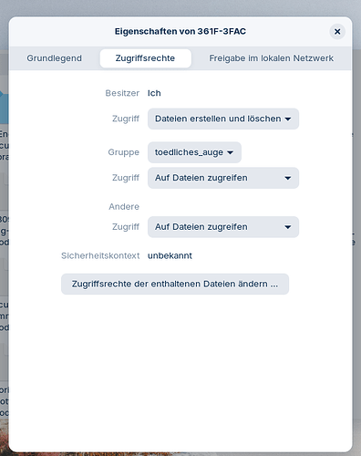

On your first Picture stands that the Filesystem is only readable. Is Your Stick some kind of secured?

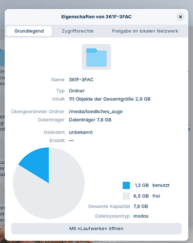

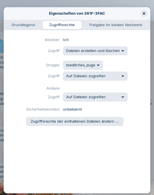

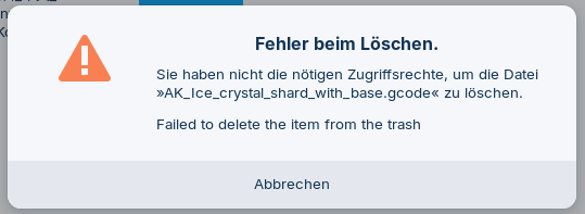

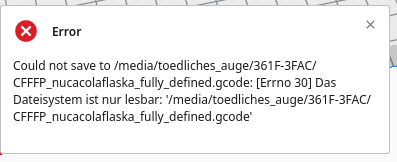

On the 2nd Picture stands taht You don't have the Access Rights to delete it. If You want to delete Data You could try it over the Terminal with a sudo Command.
The stick is actually just an SD card in an SD card to USB adapter. Don't know if that's important.
The stick came with my 3D printer. On the stick there are the configuration files for my printer and the files that I want to print.
In Windows writing to the stick works. (But I don't want to use Windows anymore)
Did You controled the SD Card? Because on SD Card's is on the Side a little Switch. With that You can lock the Card and so You can't write on them, only read.

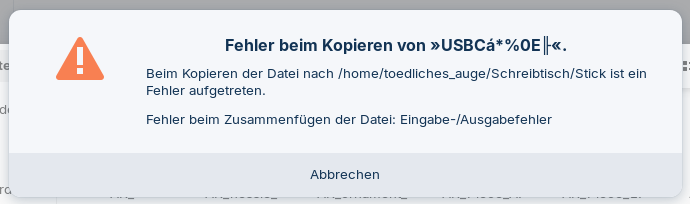

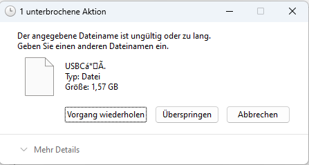

Thanks, but by copying the data, I have a problem.
It says the data I want to copy is to long (its name, but I am not sure, if that would change its behavior). But this is exactly the one data that is important.
Hmm ... I think the Problem of the Filename are the Symbols after ''USBC''. I would say Windows don't like that. Did You tried if You can copy the Files on Zorin? Maybe it can handle this better.
It could exist. But to be honest I have no Idea what Command or Commands are need for this. Maybe a more experienced User like @zenzen or @swarfendor437 could give a helpful Advice for this.
The only Thing what I would think form the Zorin Error Message that maybe the File is broken.
I think I would go for @swarfendor437's approach on this one: copy the contents of the drive to Windows and either format the SD Card or use a new one. SD Cards are notoriously unreliable and wear off rather quickly, and while I can't be sure of it those last few error messages on both operating systems seem to point to something wrong with it. The filename is another indicator that something may be wrong with the SD Card, as it suddenly cannot read it out correctly anymore (notice the names are different on the error messages shown on each OS).
