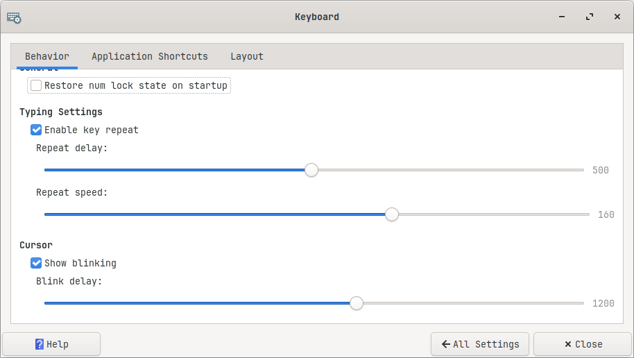

It is getting more and more annoying...it is happening all the time now. I have no such setting. I would LOVE to disable this...
And it's not in Accessibility, either...
Or mouse settings
Or keyboard settings...

Your profile says "Lite" but Zorin OS Lite does not have an alt+two finger scroll by default, whereas Core does...
Can you please verify - confirm edition?

I really don't know what I have, I went to the download page and downloaded what was there... I only see core there, so I assume that is what I have. I see no place to download a 'lite' version. I looked all over in the setting to tell me what is installed, but couldn't find anything.

The screenshot you showed above looks like Core to me...
