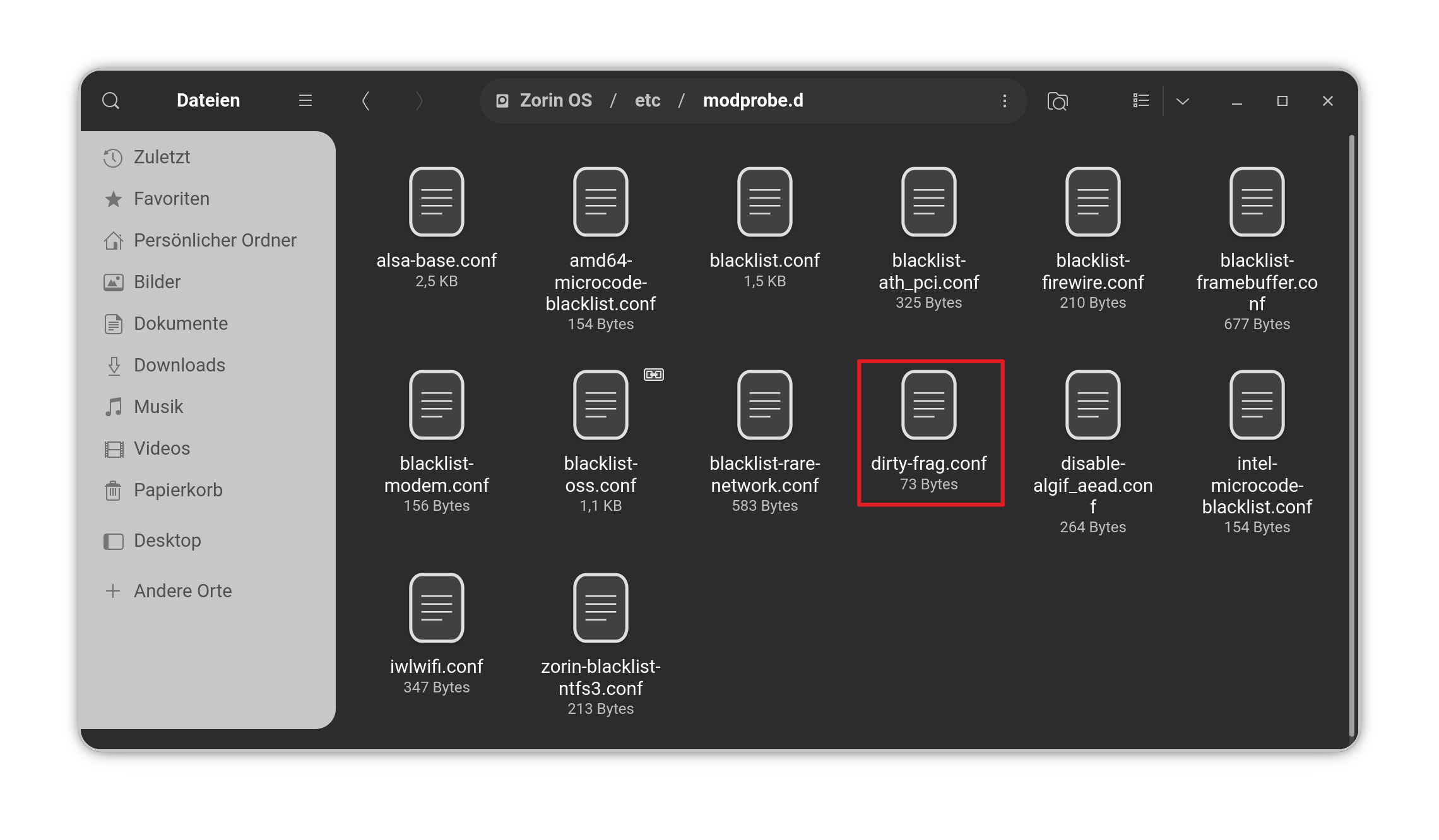

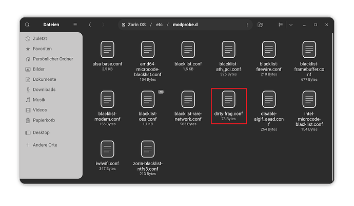

Some might already know but there is a new risky Kernel Security Issue called Dirty Frag. Unfortunately the Infos about it were published too early before somekind of Patch is available.
There is a Workaround for now that disables Kernel Modules. In the Ubuntu Blog, You find the Steps to make that:
https://ubuntu.com/blog/dirty-frag-linux-vulnerability-fixes-available
When done, You should find in /etc/modprobe.d/ a File called dirty-frag.conf
And in this File should be the Content:
install esp4 /bin/false
install esp6 /bin/false
install rxrpc /bin/false
To make that clear again: This is not a Security Fix. It only disables the affected Kernel Modules to avoid an Issue for now.
