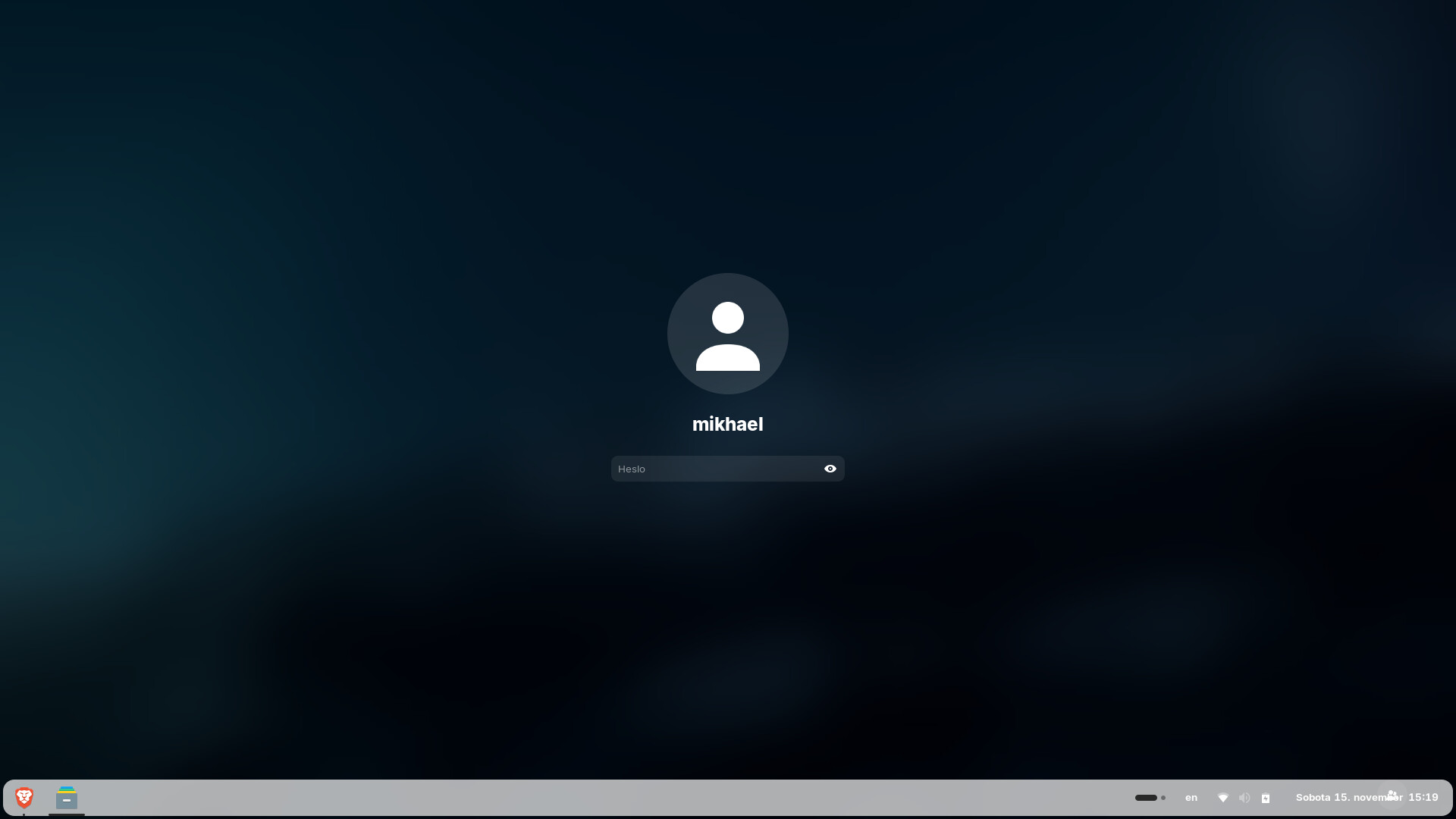

This is what happens when I set the computer to sleep after x minutes of inactivity and when i come back on Xorg
Hmm ... Okay, let's try it with reinstalling the Zorin Desktop and the Login Screen:
sudo apt reinstall zorin-os-desktop gdm3
