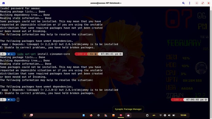

Hello friends,
I am trying to install the Cinnamon desktop environment on Zorin OS 17.2 Pro.
I am encountering this problem.
What is the reason for it?
Did you add any other Repository before trying to install Cinnamon D.E.?
(No other repository is needed. I also do not recommend adding a Cinnamon Repository, as doing so will create package conflicts).
In Software & Updates, Is your Download from set to "Main Server"? If not, please set it to Main Server.
Could You post the Output of sudo apt update to check what Sources are active? Also type apt list cinnamon-core for the available Version please.
Yes, I had this repository:
ppa:kelebek333/mint-tools
I removed it.
