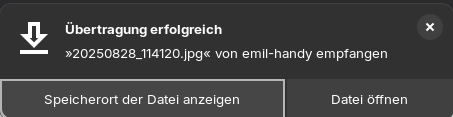

When i click open File Location in Notifications it doesnt work
Hi, i just sent a file from my Phone to My PC using Zorin Connect, and got this Notification.
The Problem is that when i click there, the File location only opens when there is already an active Window of my File Manager, or else it just does nothing.
(same with Opening downloaded Files trough Apps Like Zen Browser)
Would be great if anyone could help me with that, thx :slight_smile:

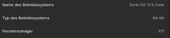

Okay, the System should run in Xorg. To be sure, You can check that in Settings>About. There You should find X11 as Display Manager.
