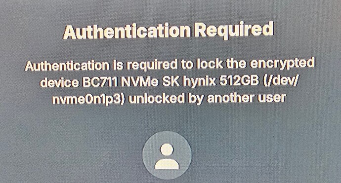

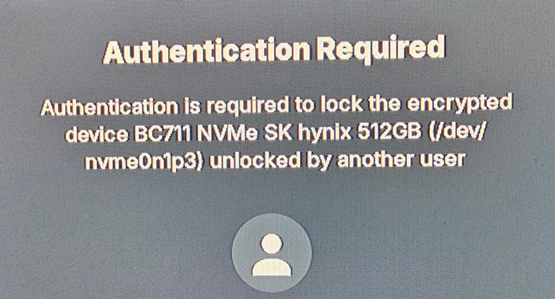

Which !&#%$^! Password is This?!?
I ask because I've tried them all (tyoed one finger at a time) MULTIPLE times now.
Were you having Bitlocker issues on a previous thread? Maybe I'm remembering wrong. "Another user" must be you? Could this be bitlocker trying to reassert itself? Is there a way of getting out of this like a cancel or ignore button.

Does anything here just work?
I'm not sure these apply as it insists I enter a PW to lock the drive.
Anither thing that's odd is that there is no other user.

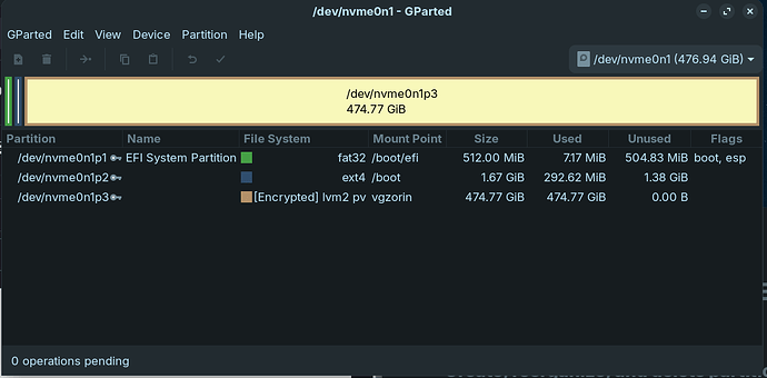

It looks like the Device has an Encryption. Could You install GParted with sudo apt install gparted and then open it and check if on this Drive is a little Key Symbol? Maybe make a Screenshot and post it here.
No special characters

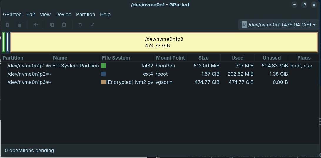

There you go. Sorry about the delay.

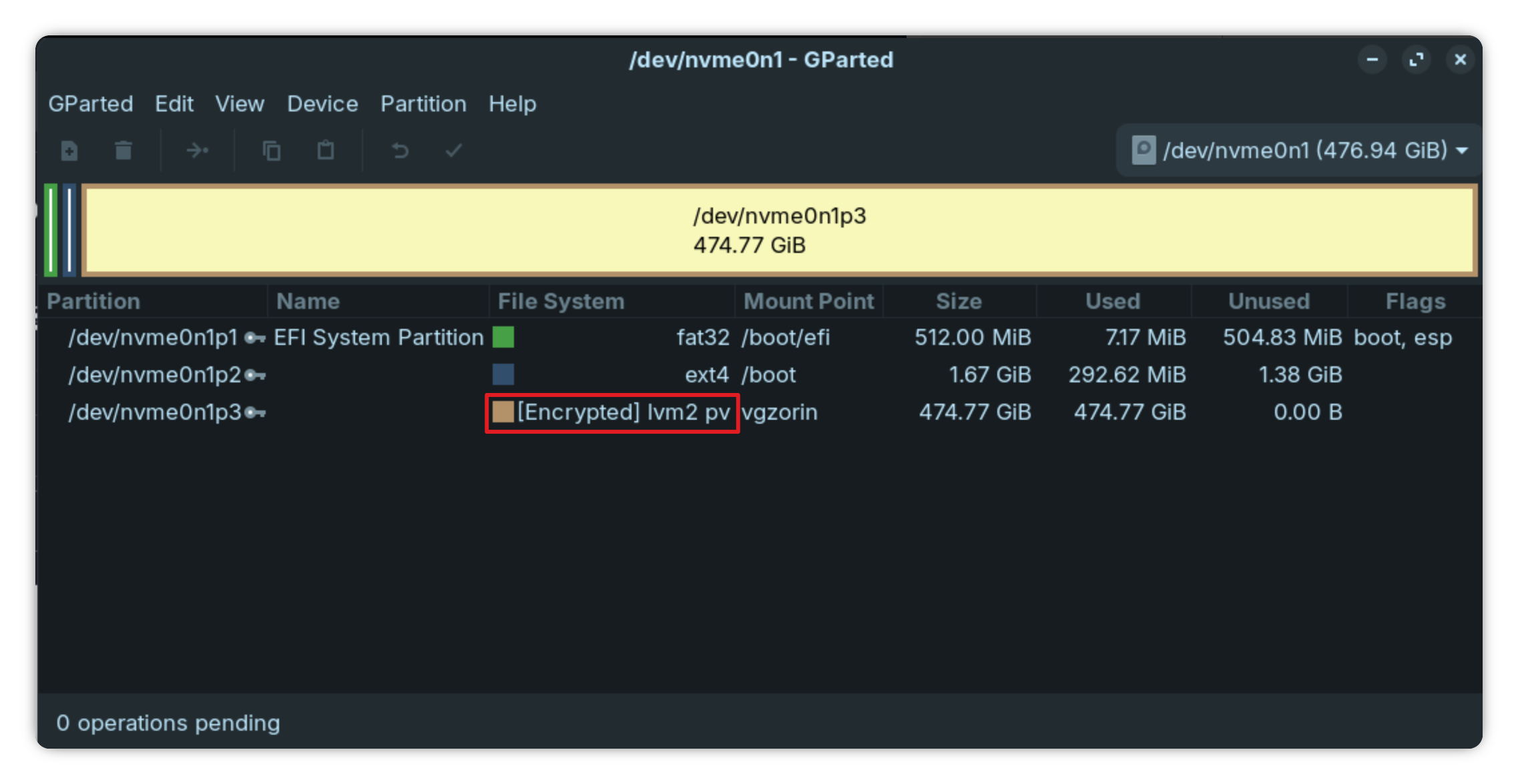

Okay, yes. Look at /dev/nvme0n1p3 and there You see that it is encrypted:
