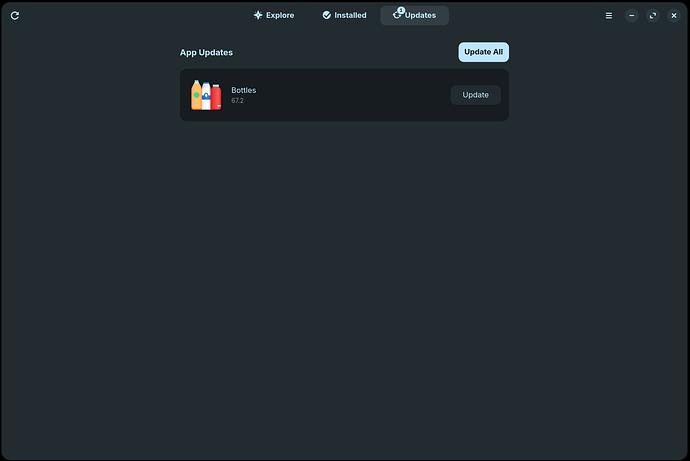

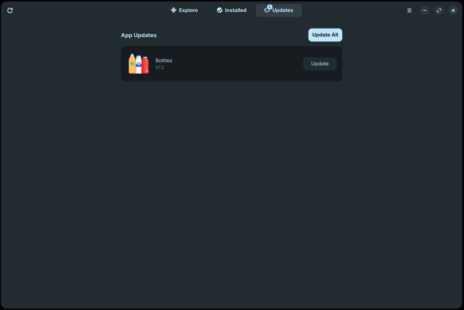

Why does Bottles want to continually update to 67.2 in the Software App?
Is there any reason Bottles wants to continually update after I have run the update in the Software App/Store a few times?

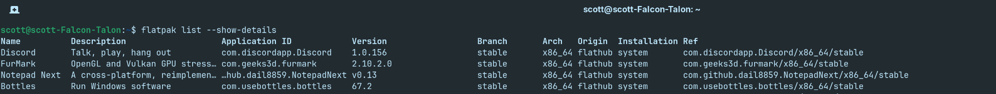

I already have Bottles version 67.2 installed - see output below from terminal command flatpak list --show-details

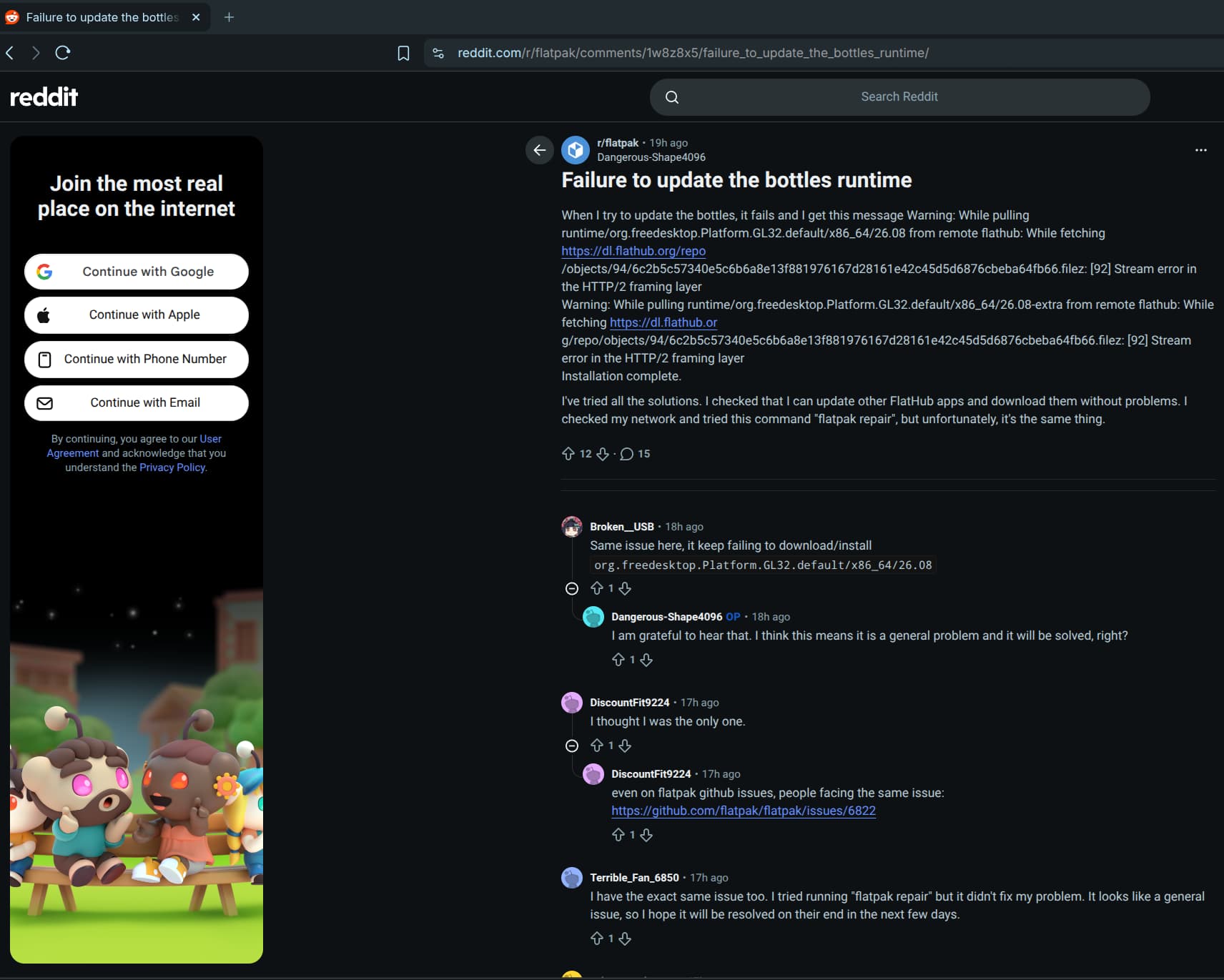

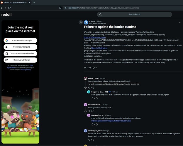

I believe you are correct that this is most likely a server error and will need maintainer fix as others have reported the same issue on Reddit.
See screen-shot:

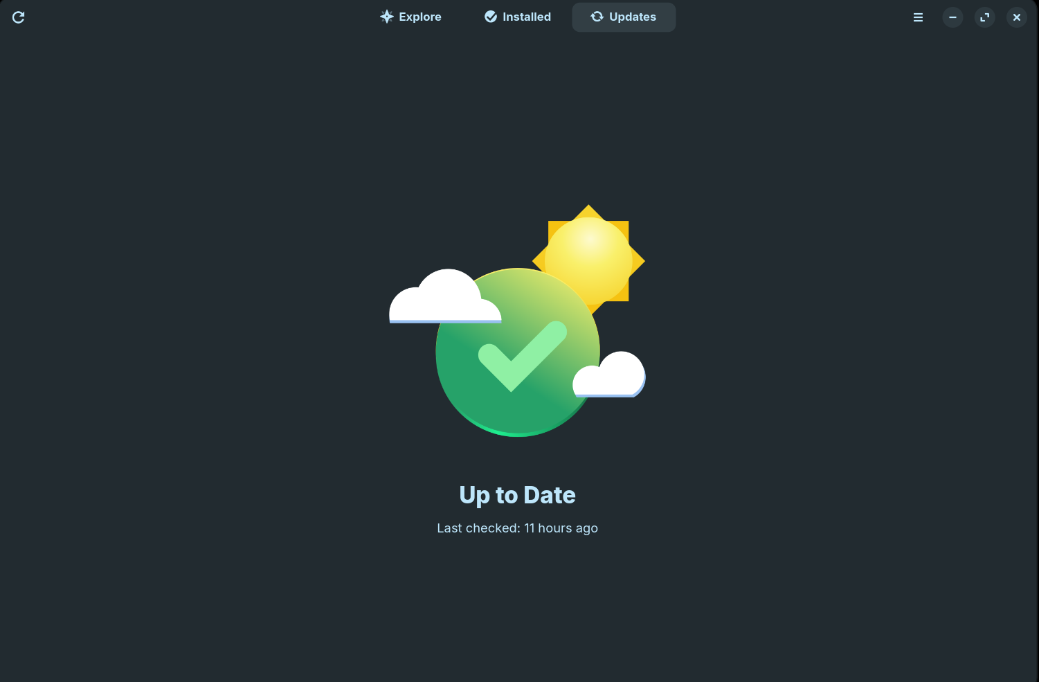

All good and working now! :grinning_face_with_smiling_eyes:
