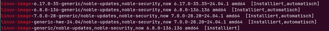

Haven't all users received kernel 7.0 yet? I haven't used my laptop Dell 7490 for a few days, and when I run apt list --installed | grep linux-image, I see something about kernel 7.0, but the system doesn't boot from that kernel even though no other kernel is set as the default, and kernel 7.0 doesn't even appear in the Advanced Options. Isn´t kernel 7.0 installed? The current kernel which is running is 6.17.0-35-generic, it is the latest which can be selected in grub menu.

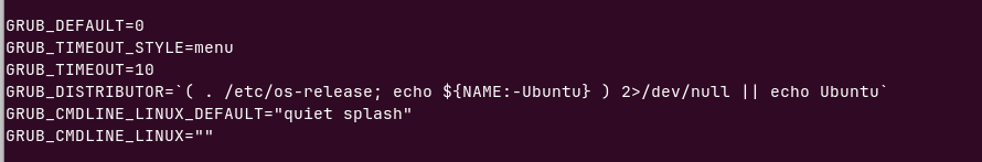

Edit: Now I set Ubuntu (Zorin) at first boot position, Until now, I had been launching Zorin from the Bunsenlabs menu and selected the Advanced Options for Zorin in that menu.
In the Zorin grub menu kernel 7.0 appeared...

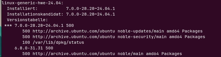

What is your terminal output for
apt-cache policy linux-generic-hwe-24.04
If it shows as none for installed, but is listed as a candidate, HWE tracking is off. You can enable it by installing it:
sudo apt install linux-generic-hwe-24.04
Kernel 7.0 is running now. Perhaps the Bunsenlabs grub menu was the culprit which was set at first boot position. I had launched Zorin via the Bunsenlabs menu, also the Advanced Options for Zorin. Now I set Zorin at first boot position, and I was able to select kernel 7.0 there.
That was the terminal output of the command:
