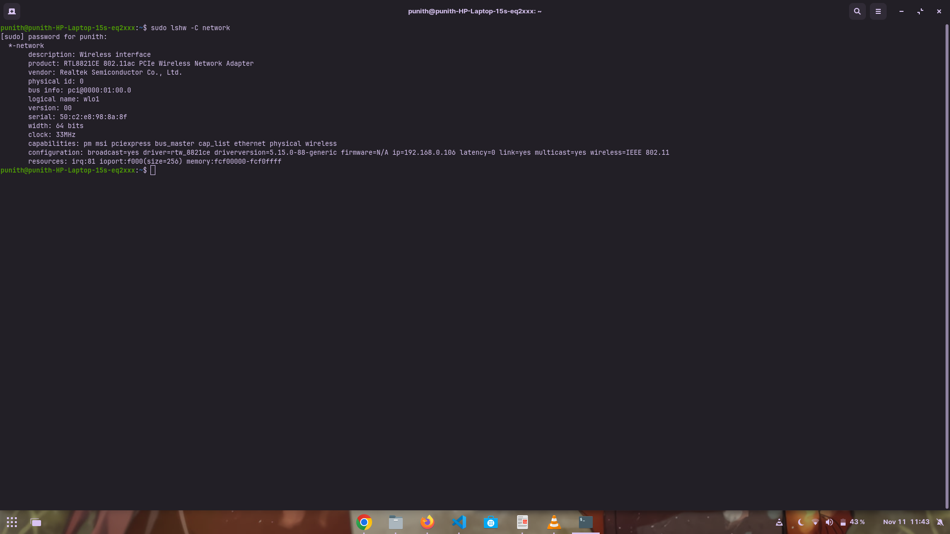

Can you please post the output for
sudo lshw -C network

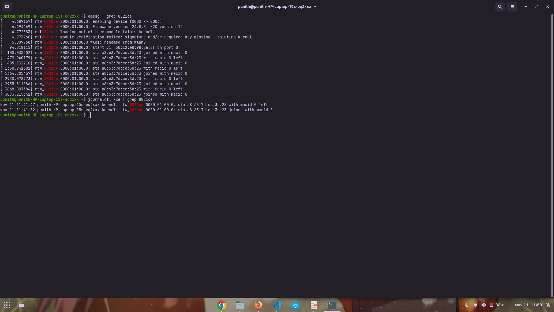

I see that you are on the 8821ce driver... You might check for error logs:
dmesg | grep 8821ce
journalctl -xe | grep 8821ce
Interesting... The module taints the kernel - it appears unsigned.
In your BIOS Settings, is Secure Boot disabled?
How did you install the 8821CE Driver? Is it installed with DKMS?
Was the wifi cutting out on an earlier kernel before the system upgrades brought the -88 kernel?

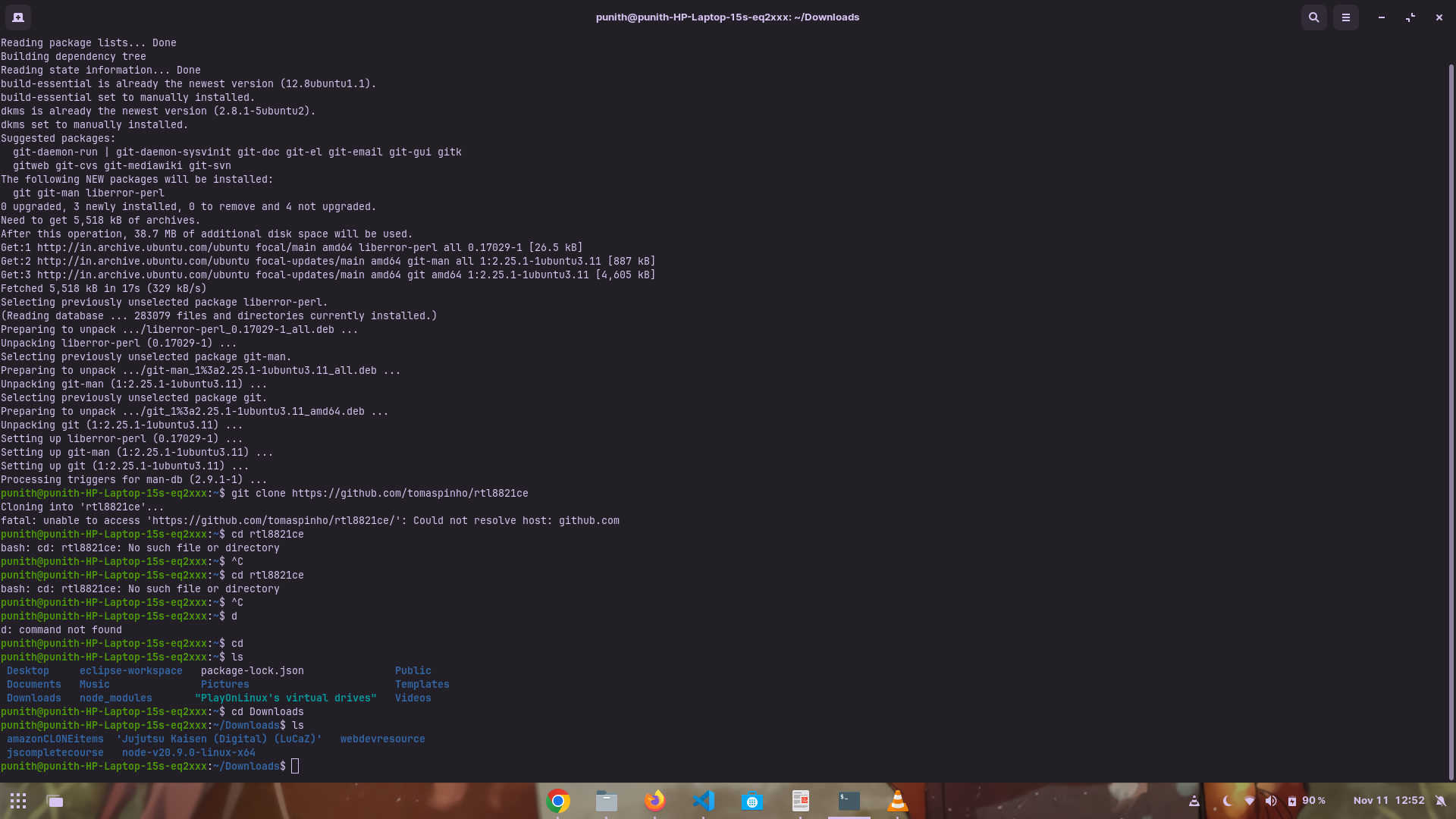

punith@punith-HP-Laptop-15s-eq2xxx:~$ cd rtl8821ce
bash: cd: rtl8821ce: No such file or directory
I just tested running git clone https://github.com/tomaspinho/rtl8821ce and then checking that the rtl8821ce folder was placed. It was.
At that point, running
cd rtl8821ce
worked. Please check that you ran the Git Clone Command above and that the folder was placed in your home directory.
In your screenshot, you see a Fatal Error.
Reconnect your net; disable any VPN or Proxy settings or check your connection.
everything is disabled.
This message is unclear. What do you mean by everything? I can see your Network was connected because the previous installations went through (git, build-essential and dkms installed via the net).

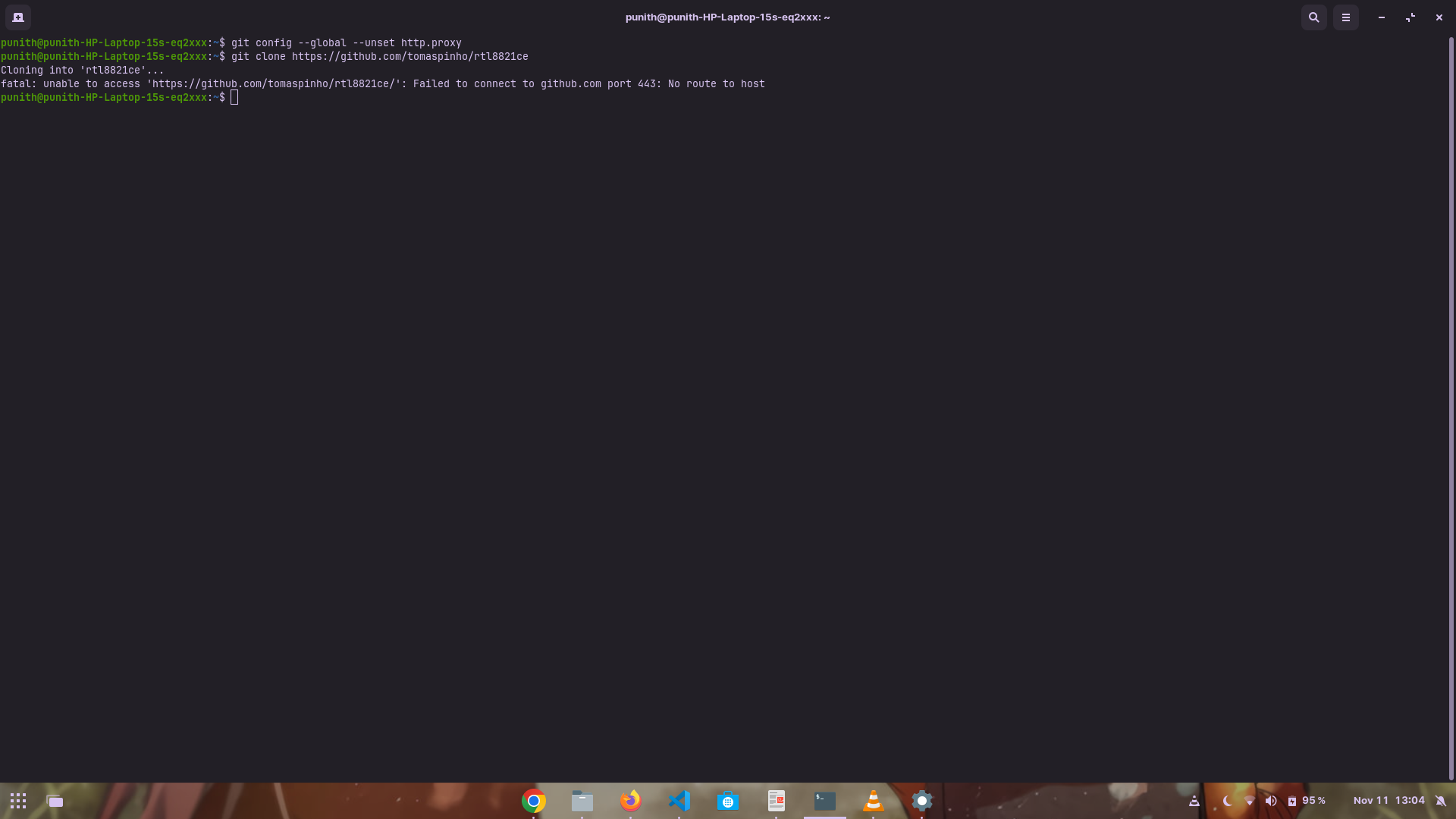

Do you use a VPN? Do you use a Proxy?
git config --global --unset http.proxy
means VPN is disabled and i don't use proxy and from few minute my wifi is working without disconnecting.
Which VPN do you use? VPN's can be tricky little beasts.
I can only suggest that you run the proxy disable command I posted above in case the VPN you are using is enabling a proxy for you.
And recheck your connection and ensure you can successfully connect when you grab the package.
